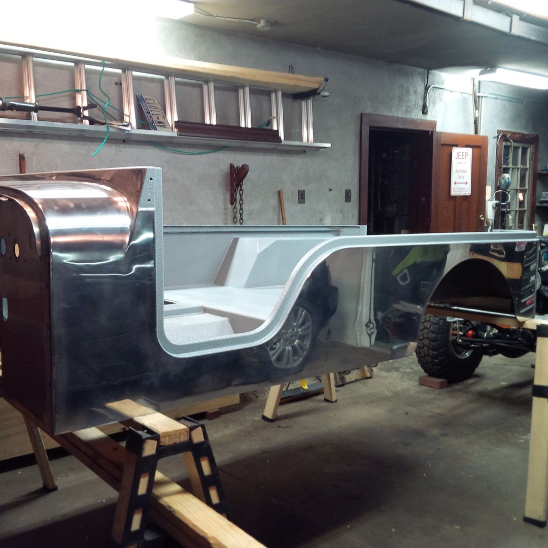

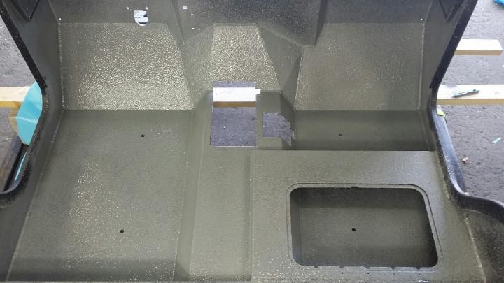

Body is home on the horses...
Time to get to work.. pleased with the results.. exterior is polished to mirror shine..
bed liner application went well, needs some touch up after all holes are drilled and car is actually driving under it own power..
I saved the ceramic coating for afterwards when the whole truck is assembled.. I wanted to get the same finish results on the steel pieces as well.

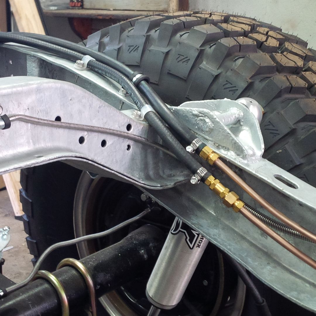

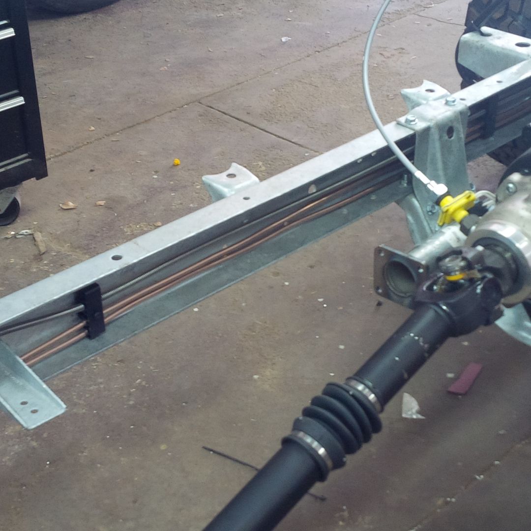

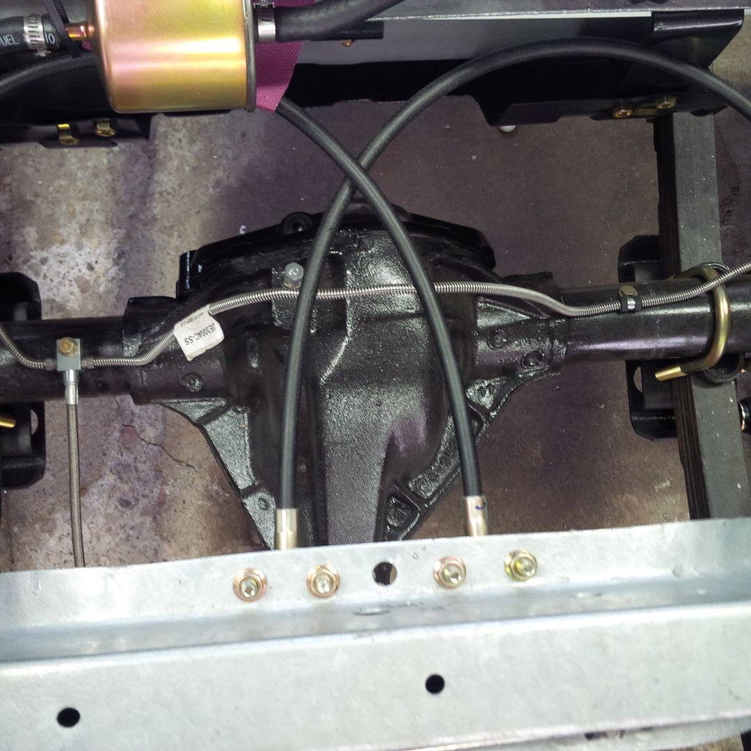

Got the Fuel and Brake system plumbed to the firewall, waiting for tub to complete install.
I’m not a big fan of rubber lines, so I ran NiCop lines along the frame.
Ebrake cables installed from Drum to equalizer

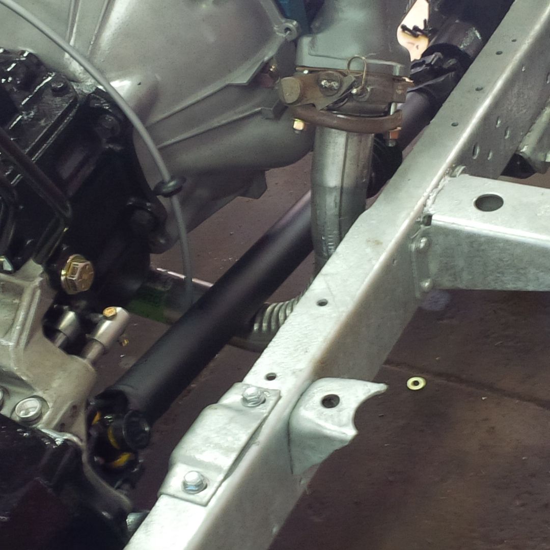

New Driveshafts installed front and rear courtesy of Tom Woods…
Might be a little issue with the front shaft and the passenger side pipe..  its ok enough to get her running and ill figure out a custom exhaust if need be once its road worthy.

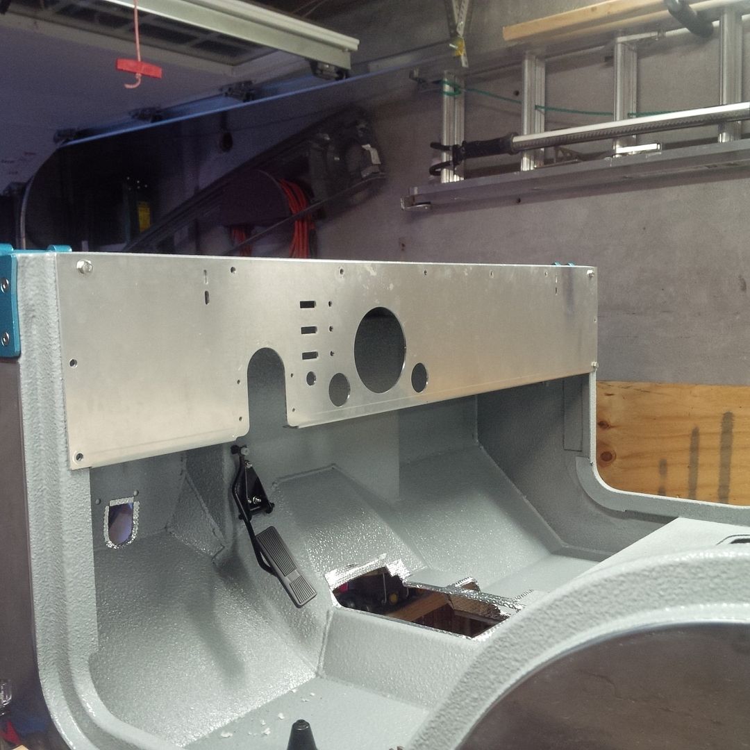

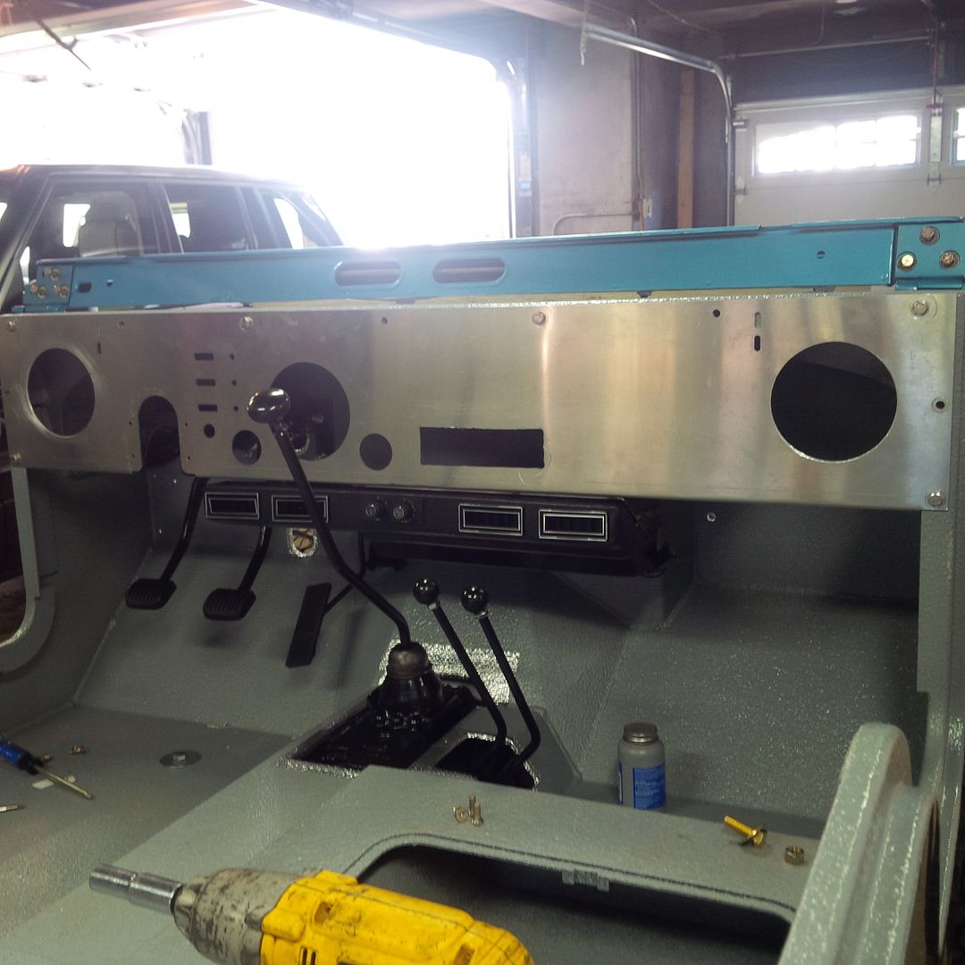

Installed the dash to get a sense of where I will need to place new holes in Dash and Firewall for various components..
Decided to put speakers in the dash along with the head unit..
Mounted AC/Heat unit to get a better understand of placement and weight..
I will deff need to add a rear support if I don’t want it flopping around on uneven terrain.

I lost the majority of the pictures of the firewall and transmission tunnel heat shielding..
I used heat shield products HP Sticky Shield..  Rated at 1100 deg direct heat and is very element resistant..
Taping up the loose seams with their “weld” tape took the majority of the time and $$$  amazing how small 36” is when your taping up irregularly cut seams…
A decent shot of the firewall with the heat shield before I mounted the body to the frame for the last time.
