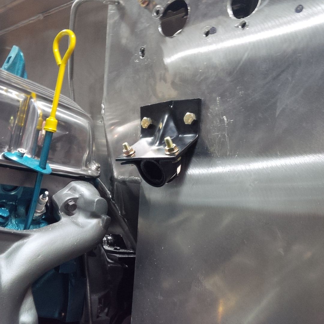

got a little work done last night..
drilled and opened up the firewall for the column bracket.
Can start rebuilding the column now.

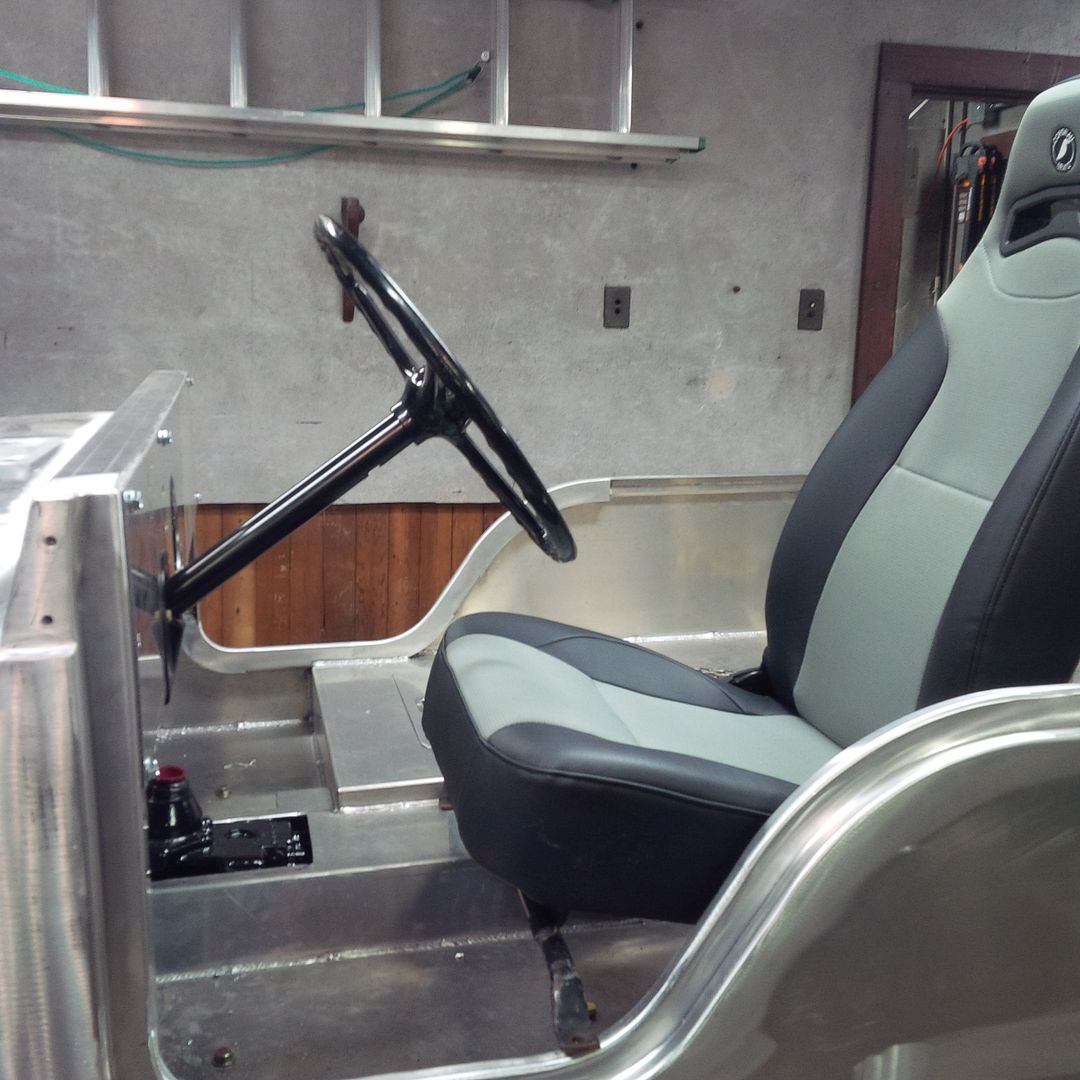

Stock seat brackets with a Corbeau Moab seat..
comfortable position (without sliders...)
Have a Mastercraft seat coming today to mock up.
