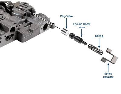

« Reply #58 on: December 03, 2016, 11:38:04 AM »
  • Posts: 23282
Re: ZJ wonder 5.0
« Reply #59 on: December 03, 2016, 03:14:54 PM »
fail.
3hrs, fluid, 100$ parts.
no change, same.  maybe 1-2 shift 5% better.  still shudders at takeoff
