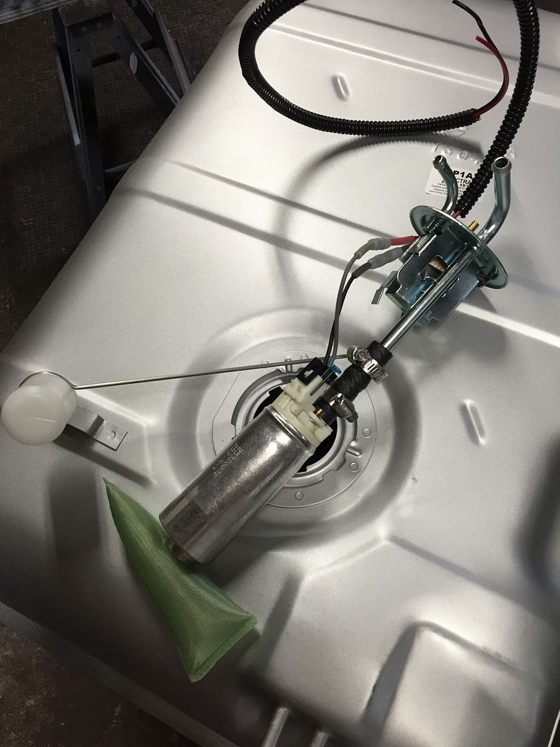

do you need to support an in tank fuel pump?  or can it just float around?
« Last Edit: June 10, 2016, 08:45:05 AM by rejeep »
« Reply #753 on: June 10, 2016, 09:17:35 AM »
the full OE type as on the left are intended to be suspended from the top collar. to run the type on the right in-tank it should be secured to the tank or somehow suspended from the access panel on a bracket.
« Reply #754 on: June 10, 2016, 09:21:45 AM »
the picture on the right is confusing to me, never seen such a thing
« Reply #755 on: June 10, 2016, 09:40:54 AM »
I think I've seen that type in use in fuel cell multi-pickup setups. didn't dig through liquid iron facebook for an example but I'm almost sure it's Timmay's work I'm thinking of.
« Reply #756 on: June 10, 2016, 09:54:30 AM »
Road duty would be fine but off-road, either in the pic seem less than optimal.  That's a bit of mass at the end of a rubber hose that has liquid sloshing forces acting on it.
I'm picturing a GM style with the spring-loaded sliders to help support/stabilize it.
« Reply #757 on: June 10, 2016, 10:41:22 AM »
I don't know what's on the left in that picture..
just the sending unit and suspended pump
flare sending unit and call it a day?

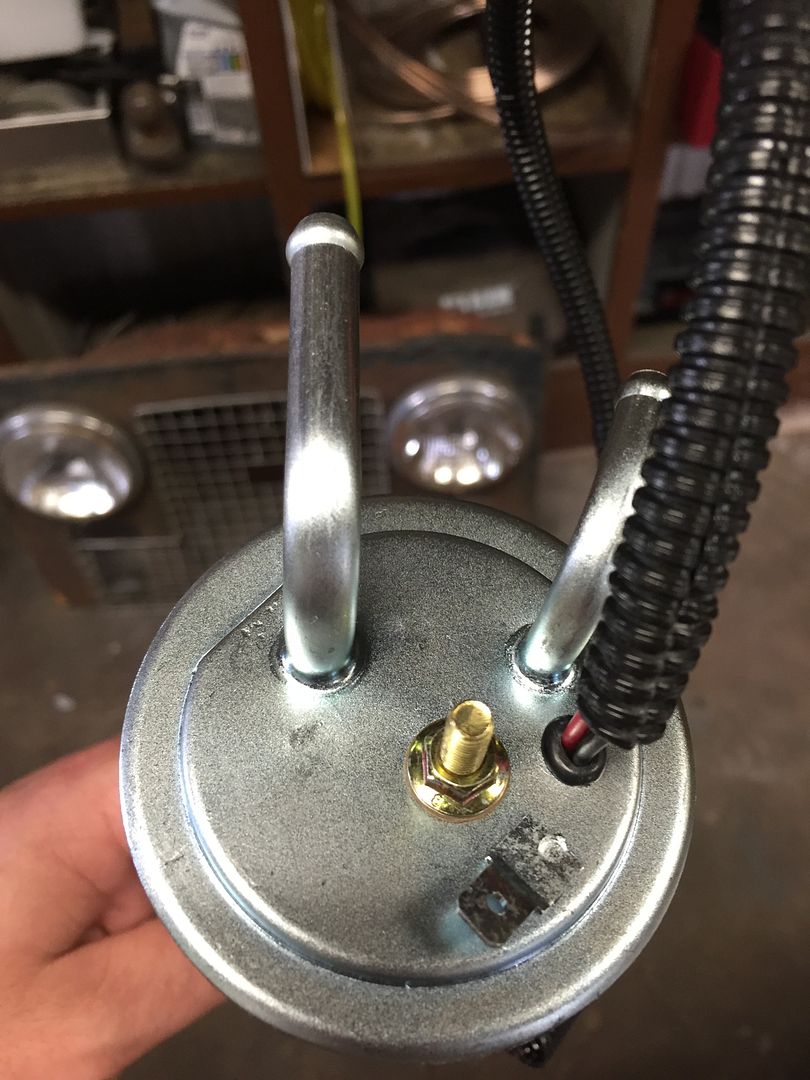

been poking around this weekend making a sending unit...
need to find some good fuel resistant epoxy to seal up the wires and I might be ready to drop the tank..
