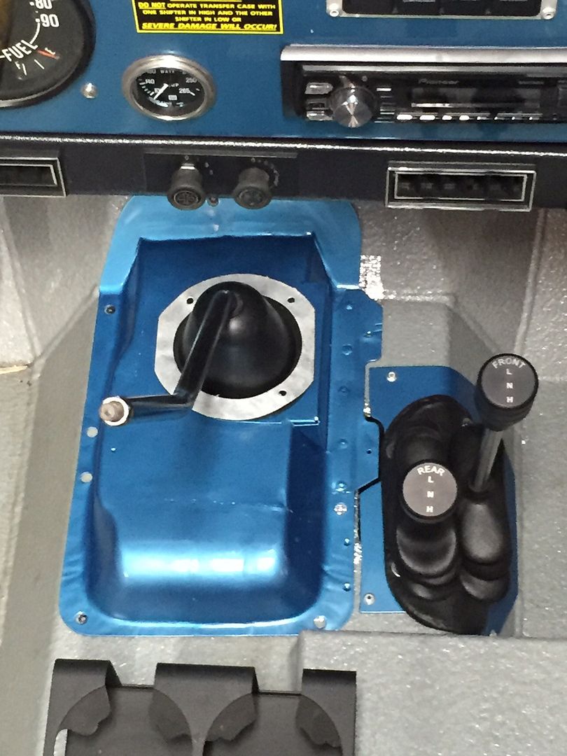

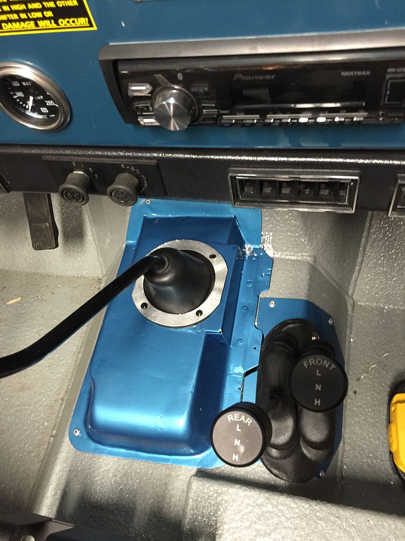

thoughts...?
has some time, sandpaper and paint...
was going to do floor liner, or is the contrast appealing?
I happen to galvanize the shifter boot ring, and had solid core aluminum rivets from the Rover laying around..
« Reply #722 on: April 02, 2016, 06:31:39 PM »
I don't mind the blue accent.  Breaks things up a bit.
« Reply #723 on: April 02, 2016, 06:31:58 PM »
i think bedliner in that color would look cool.  or throw some filler and sanding on someones weld seems that were suppose to disappear in beadliner  :)
« Reply #724 on: April 02, 2016, 07:00:06 PM »
I spent 29 min spraying it...  Wasn't committed or would have done some body work.
Might run it for a bit.  And become lazy and leave it.

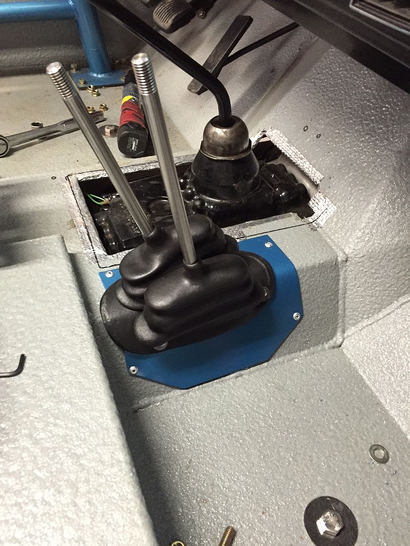

started plugging the bolt holes.
Guy at work said use a penny and weld em up..
The copper conducts, but it doesn't stick. (In a lab)
On a shoddy welding bench it burns, or newer pennies are made of magnesium...
Needs more more grinding before filler..
  • Posts: 2205
« Reply #729 on: April 04, 2016, 09:25:48 PM »
I've used small aluminum blocks before with good results.
1973 CJ6
« Reply #730 on: April 04, 2016, 09:55:07 PM »
Ditto on aluminum. good results.
I tried it after seeing brass/copper(?) used.
« Reply #731 on: April 04, 2016, 10:32:07 PM »
Not much Cu in pennies anymore.
97.5% Zn, 2.5% Cu since 1982.
