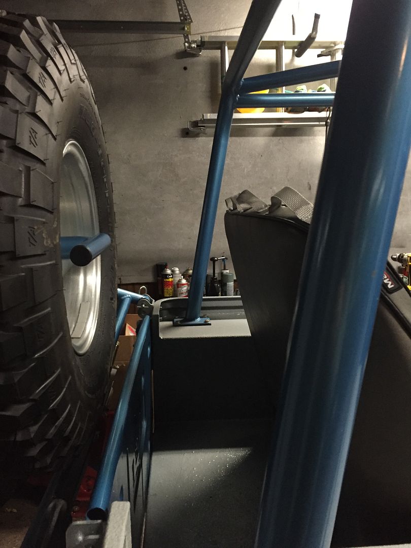

thinking about restraints for the rear...
I still want to have the functionality of a load space if ever needed.. but I also have the ok to take the kids if I get 5 pts in the rear...
I think a whole rear area sub frame tied to the cage is just overkill...
Seat is bolted to the floor..  I think I would bolt lap belts to tub as well..
would it be possible, and safe to use tube collars and make a removable chest harness bar?
Im thinking something that spans the width of the cage, slight rearward bend....
« Reply #738 on: April 22, 2016, 11:07:01 AM »
ya that would be fine.  just what i was thinking before i scrolled down to see the second pic.
Lab and sub belts fine to that tub- id put some fender washers on the bottom side of hardware if you have any consern about it, but its got to be 3x stronger than any production unit i have cut up.

Tube collars in hand...
Smike is this a shop visit or a bench job?
« Reply #745 on: May 23, 2016, 11:47:31 AM »
ill need it dropped off. it will have some bends in the bar to off set it towards the rear of the tub a little.  This will make it so the clamps are actually removable.  if i recall those pillars are parallel so it cant just be a straight piece of tube or you would never get it in our out.
