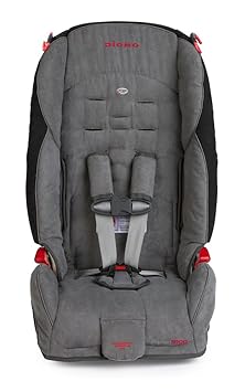

rear seats purchased today..
narrowest car seats I can find that still satisfy my safety requirements...
17" wide x 2 for 36" between the fenders !!
