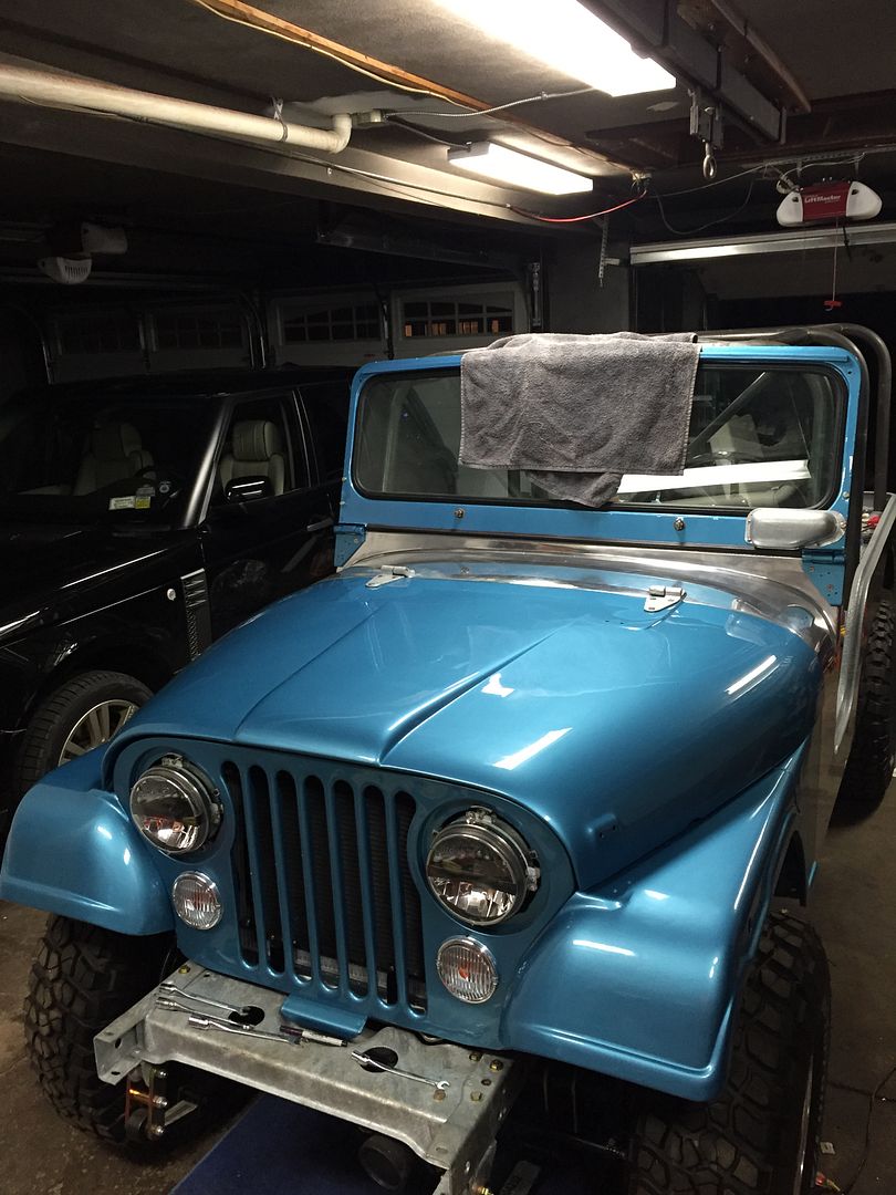

    Got the heater unit mounted..
    AC and Coolant lines plumbed to bulkhead
    need to wire AC/Heat on a separate circuit, thus another custom harness..
    for a "painless" system I have been doing a lot of additional harnesses....
    Head some issues with the speedo cluster.. should have those remedied shortly..  Issue with self grounding cluster lamps and too much aftermarket plastic...
    Hood painted and on truck
    hinges needed some reaming to remove the galvy and I press fit the 2 part hinges with moly engine lube..
    yes, the hood wont be pull-off-able.. but it will be secure and hinge-able..
    Aqualu provided shims to compensate for radius curve of cowl.. ordered hood rubbers and cowl/hood seal from a YJ before final adjustments are made.. (trimming shims and final placement of hood)
    « Reply #598 on: April 07, 2015, 10:46:59 PM »
    Have I said how much I love that color? Dam!
    « Reply #599 on: April 08, 2015, 09:11:53 AM »
