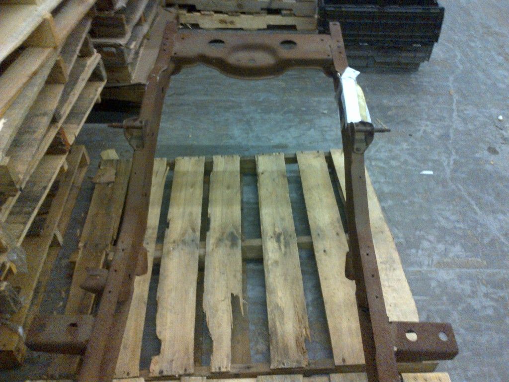

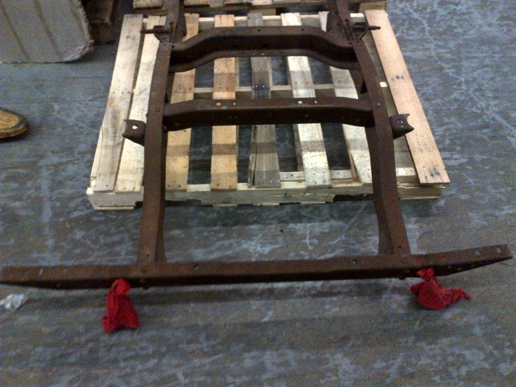

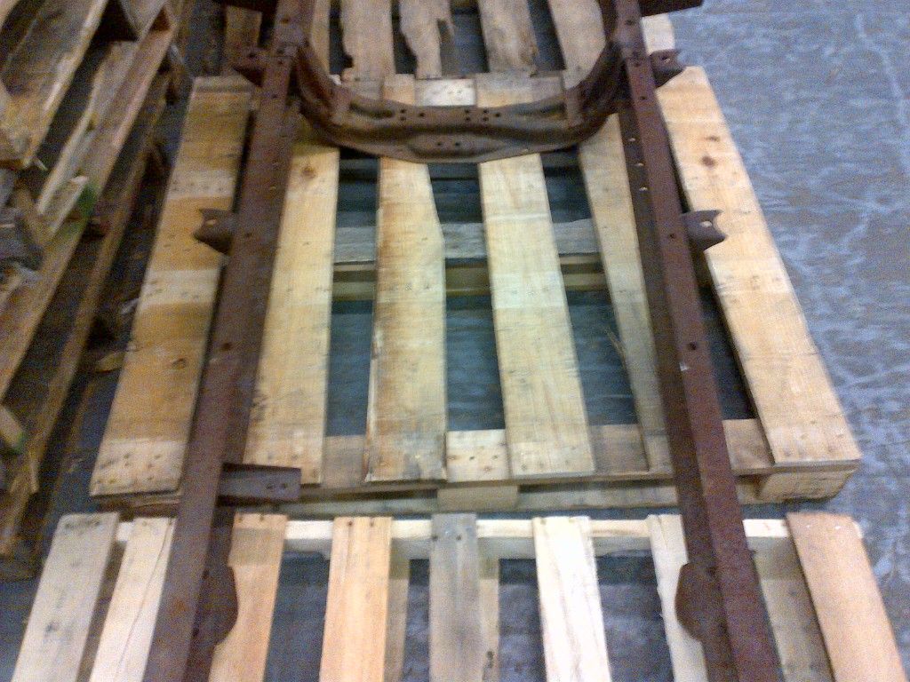

« Reply #64 on: March 05, 2013, 10:16:54 AM »
Frame arrived in Rochester last night...
is in better condition than expected to be honest...
« Reply #65 on: March 05, 2013, 10:59:23 AM »
Blast and powdercoat?
« Reply #66 on: March 05, 2013, 11:30:33 AM »
depending on what gets screwed, glued, or welded I am thinking Hot Dip Galvy after its all mocked up...

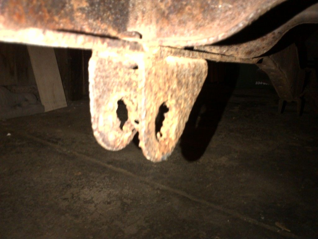

spent a little time looking the frame over...
Smike I might be making a punch out list for things I need welded...
this is the passenger side shackle hanger..
the sleeve is all rotted out..
the passenger rear is close to the same while the drivers side is "ok" but would rather be safe than sorry...
will these work?

« Reply #68 on: March 08, 2013, 07:41:49 AM »
If thats the case. Cut them off and buy new 1/4" thick hangers too.
« Reply #69 on: March 08, 2013, 08:04:35 AM »
Coil buckets?
« Reply #70 on: March 08, 2013, 08:07:25 AM »
leaves are found naturally in the woods... coils on the other hand
« Reply #71 on: March 08, 2013, 08:11:13 AM »
is that bracket the inside leave mounts?  i dont under stand the picture, or is that the outside mounts?
« Reply #72 on: March 08, 2013, 08:24:23 AM »
that’s the front shackle hanger.. there is suppose to be a metal sleeve there that rotted out where the bushings go into for the top shackle bolt...
I am debating between replacing the whole mount with a Ruff Stuff piece or leaving the factory riveted hanger and just doing the sleeve…
Thoughts?
« Reply #73 on: March 08, 2013, 08:32:46 AM »
being a 73, i bet the sleeve wasnt installed, those things are beefy- no way it rotted.
i guess it would depend on what springs your putting under it which way to go with the mounts-
« Reply #74 on: March 08, 2013, 08:38:47 AM »
Aren't YJ leaves wider anyway?
