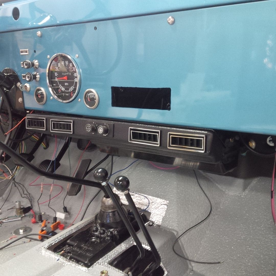

Time for a real update...
Still tackling some of the more PITA wiring chores..  trying to button up the dash so I can perm mount the Heat/AC unit.
Working on the turn signal switch and other dash wire chores.
gauge cluster is kinda working, need to spend some time in there with a test light.
Still need to cut another hole in the dash for the aux switch pod... just want to get the wires I have in there already termed and functioning.

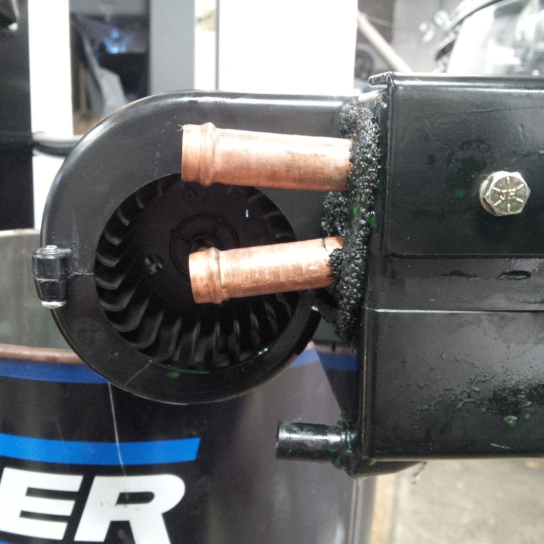

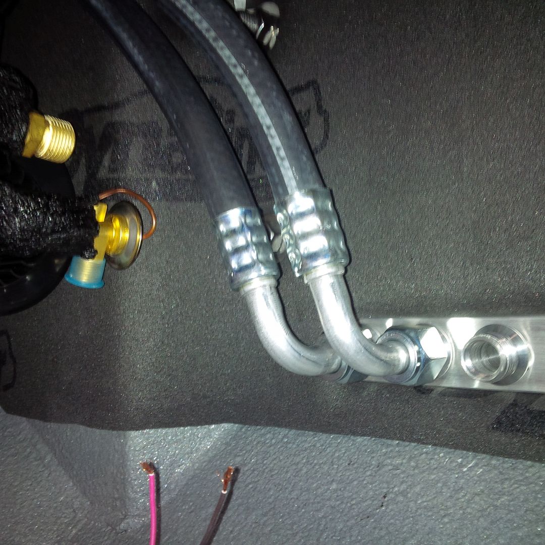

Got the air handler all mocked up.
AC lines shouldn't be an issue.. it will be tight under there, but manageable.
Going to need to replace the bulk coolant lines with some 90 deg elbows to allow for best coolant flow.

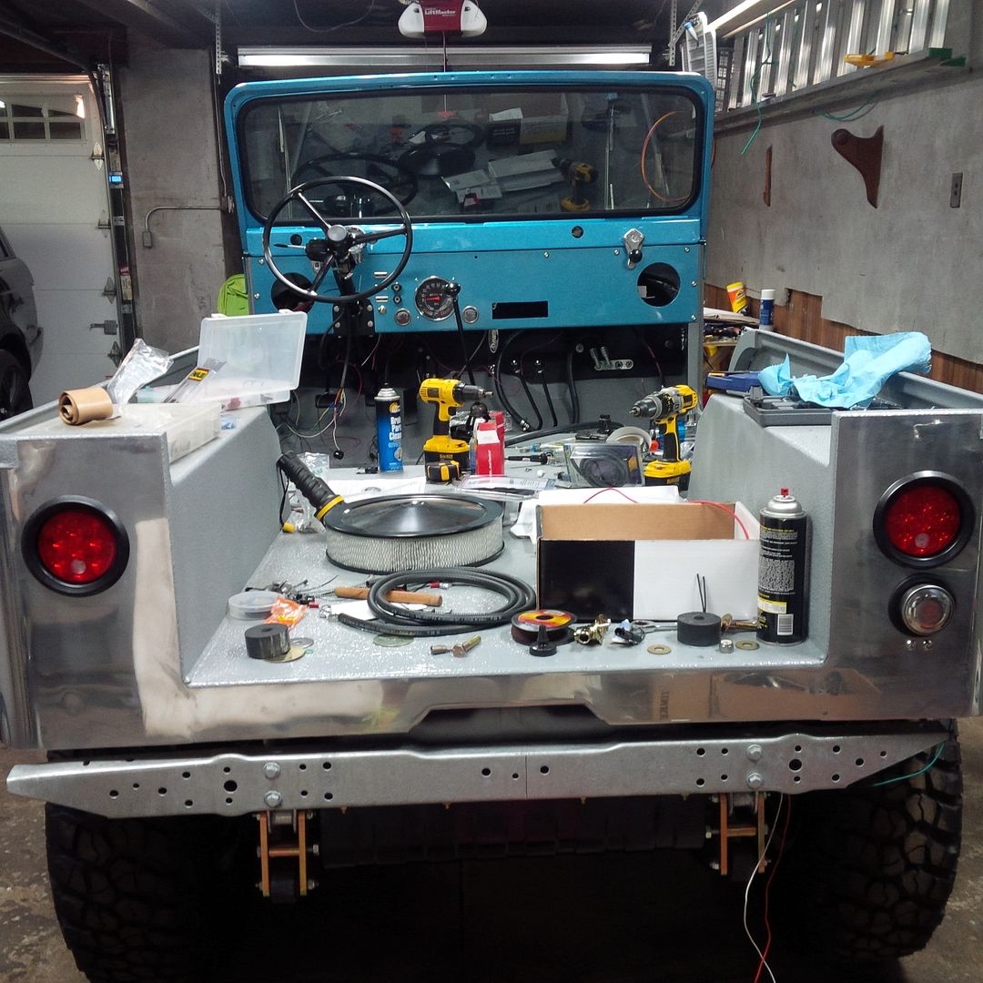

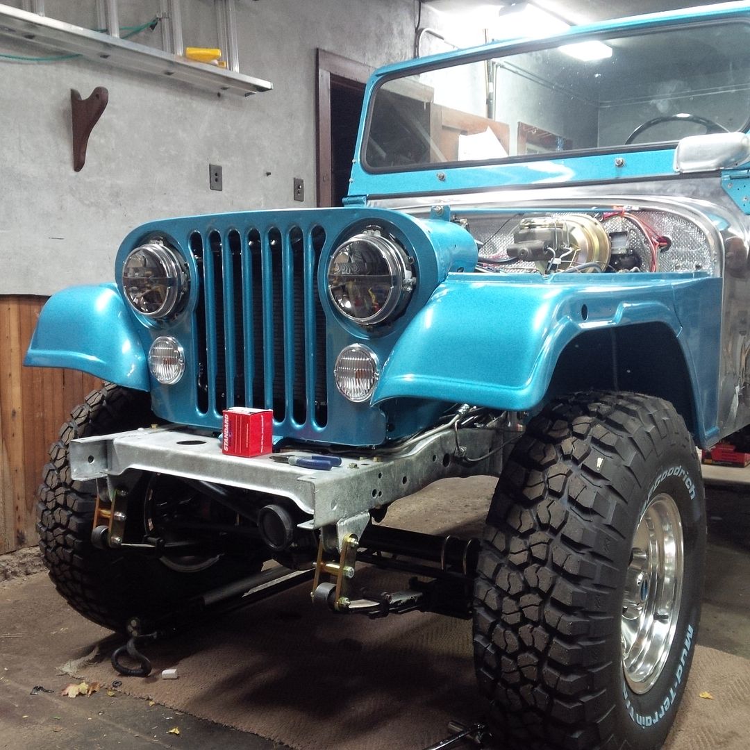

Both fenders on and perm mounted...
starting to load up the interior with crap...  It was a small celebration when both the coolant and washer fluid fell snuggly into place.  I think I am going to add some weather pack connectors in the main harness if the fender or grill ever needs to come off..
Rear of the Jeep came out nice..
just need to drill holes for the tailgate and fabricate a way to latch it. (Factory tub had chain tabs.. not present on Aqualu)

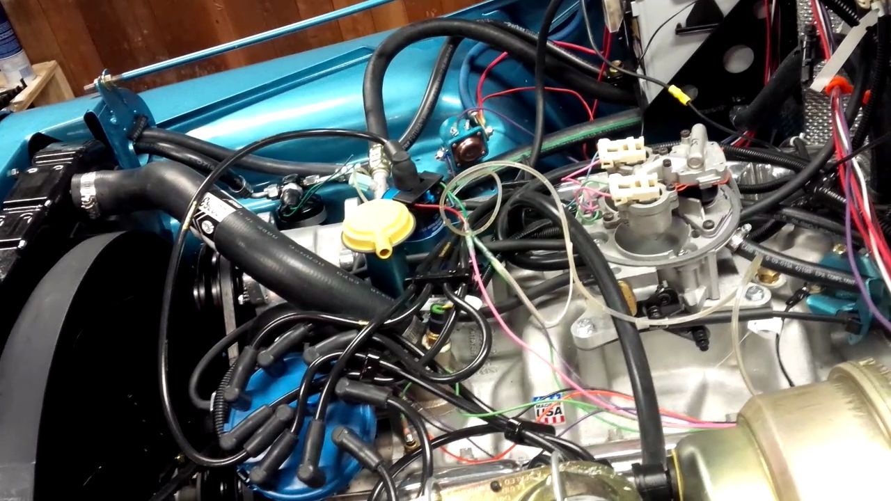

Motor is purring and after swapping out the driver side valve cover gasket and a new copper washer in the oil filter housing i'm running leak free, for now....
Still haven't ran it for more than a few min.. given that I don't have a full exhaust system on the truck.

ed, has those same windshield hold down knobs brackets.  they dont hold the windsheild straight for shit.  soft top pulls it back too far, doors dont fit, back window is flopping.  boo
« Reply #463 on: October 20, 2014, 01:05:53 PM »
 I can adjust the rake very easily..
shouldn't be difficult to adjust..
I mocked up my fiberglass doors and they both fit snug..
