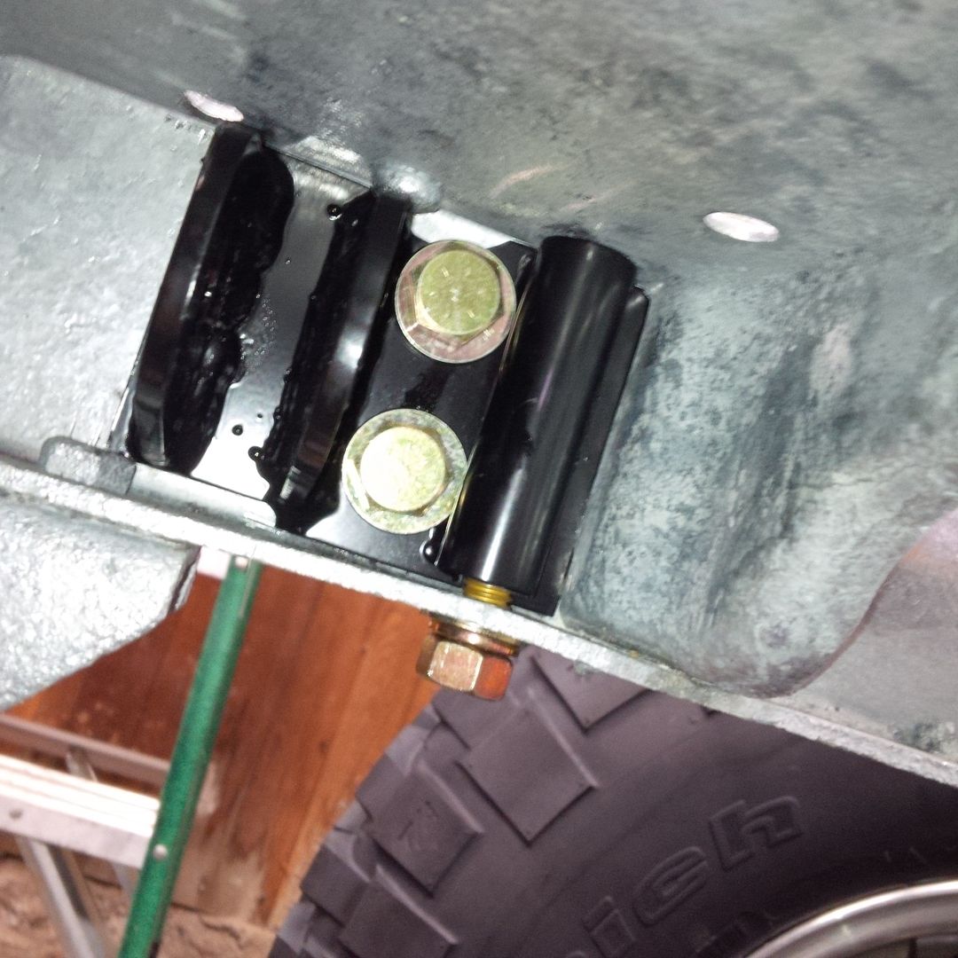

« Reply #228 on: January 12, 2014, 08:16:26 PM »

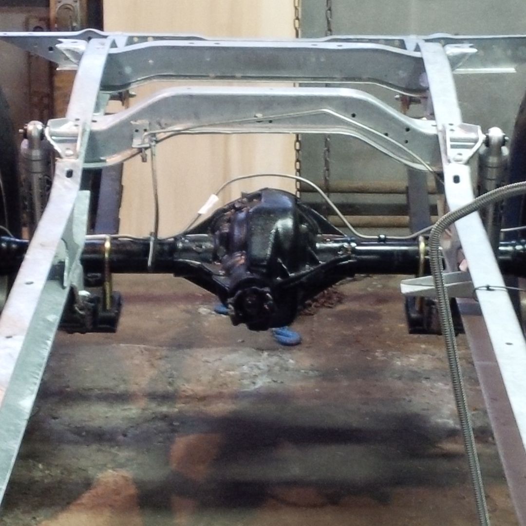

Got some misc work done on the frame today..
Started the running the rear brake lines...
76-86 SS flex lines do not work with the 73 pre bent SS lines..
Need some adapters... :o
Motor frame mounts positioned.. and of course 72-75 Jeeps require some "drilling modification"
New lower shock studs made.. better alignment with the top studs.

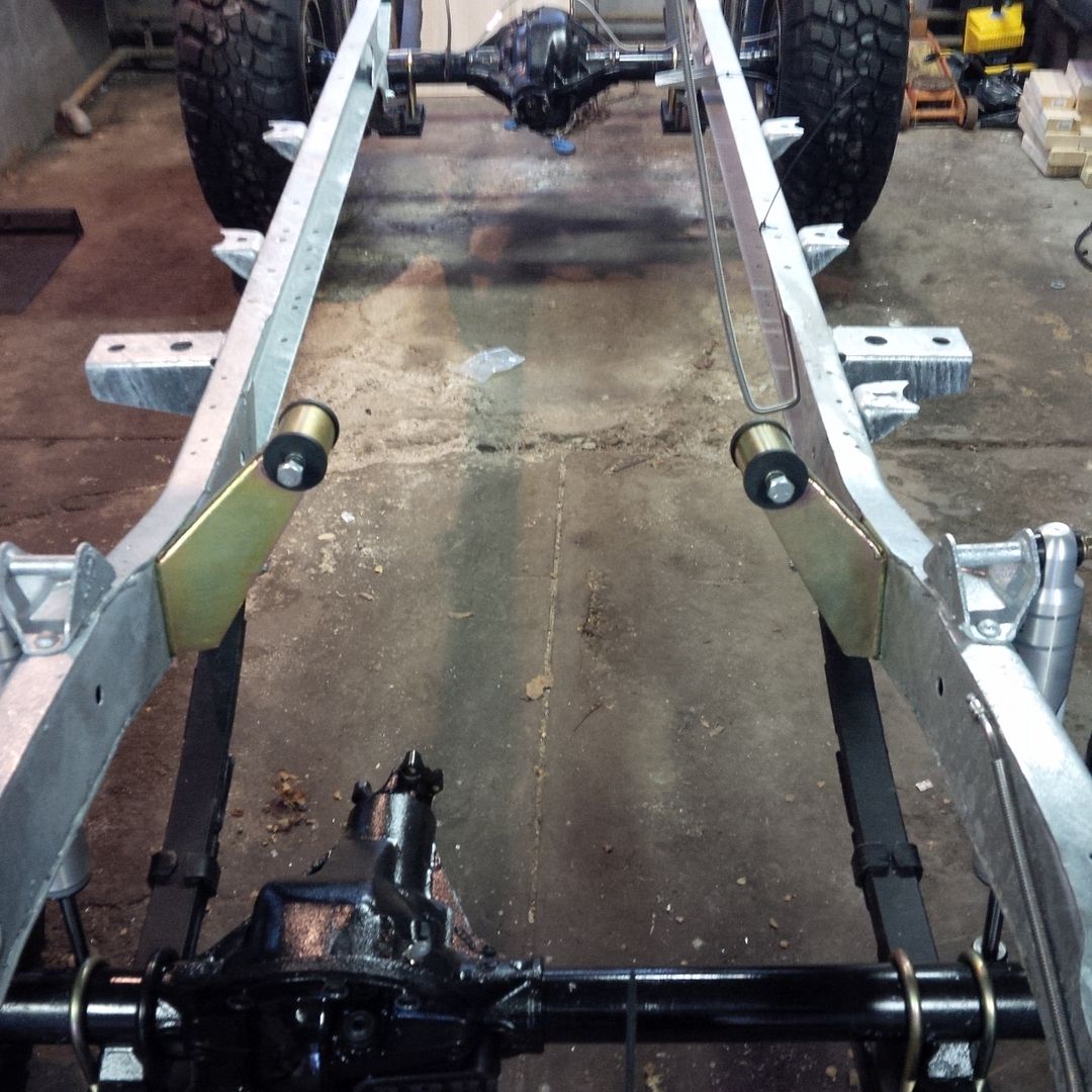

« Reply #229 on: January 14, 2014, 08:17:14 PM »
What brand motor mounts?
I know u have brown dog in the yj.
Looking to purchase new HD for cora's 360 in lieu of fab.
« Reply #230 on: January 14, 2014, 09:26:17 PM »
M.O.R.E

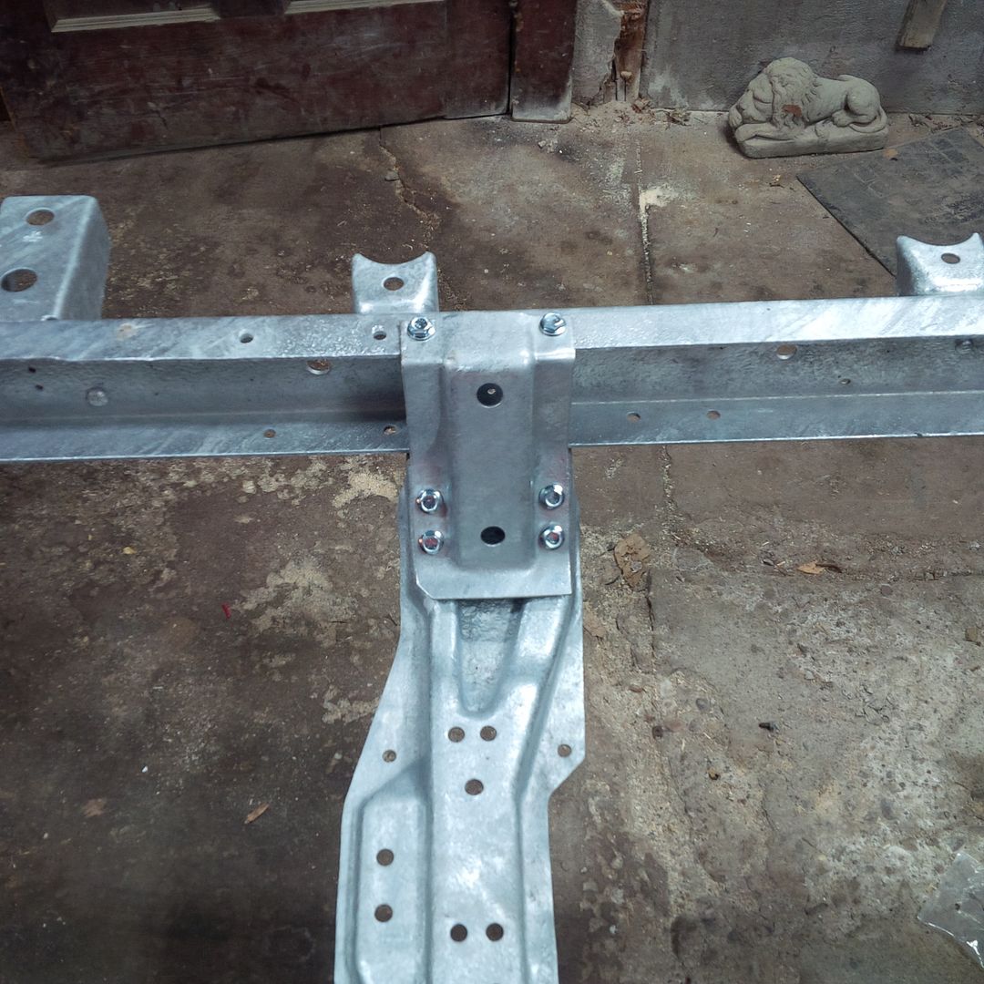

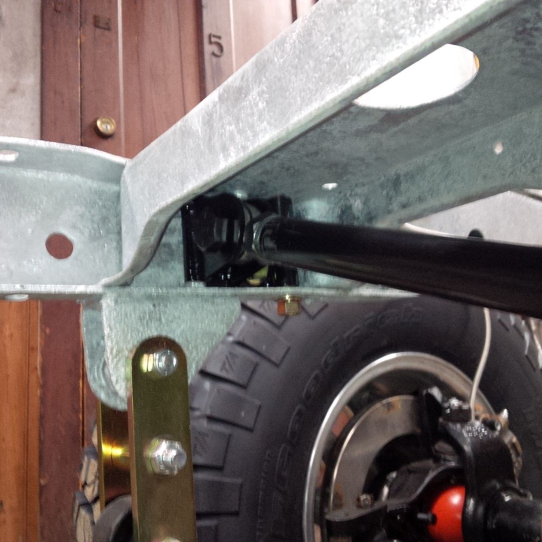

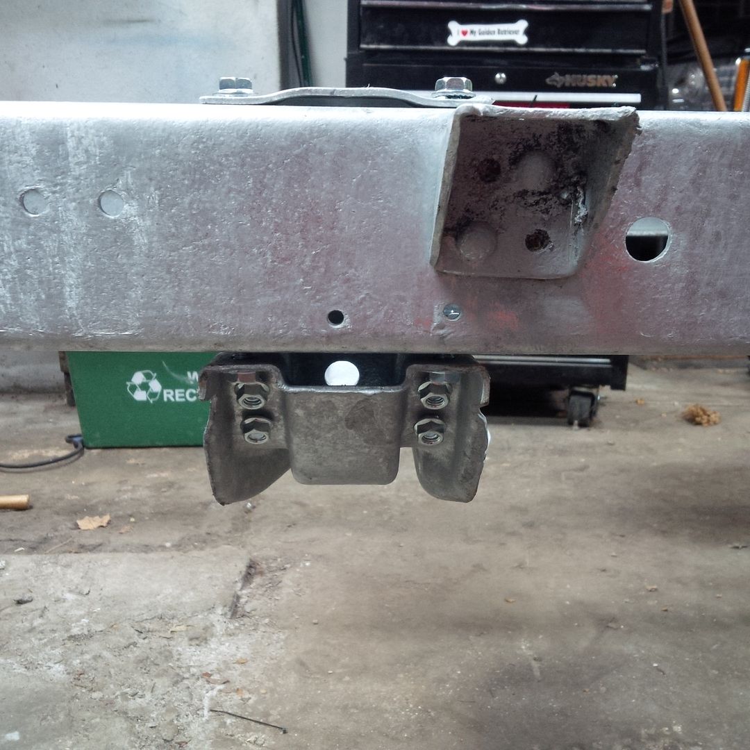

« Reply #234 on: January 17, 2014, 10:41:15 PM »
crossmember mounted tonight... seems there are 2 stock positions so its just finger tight for the moment..

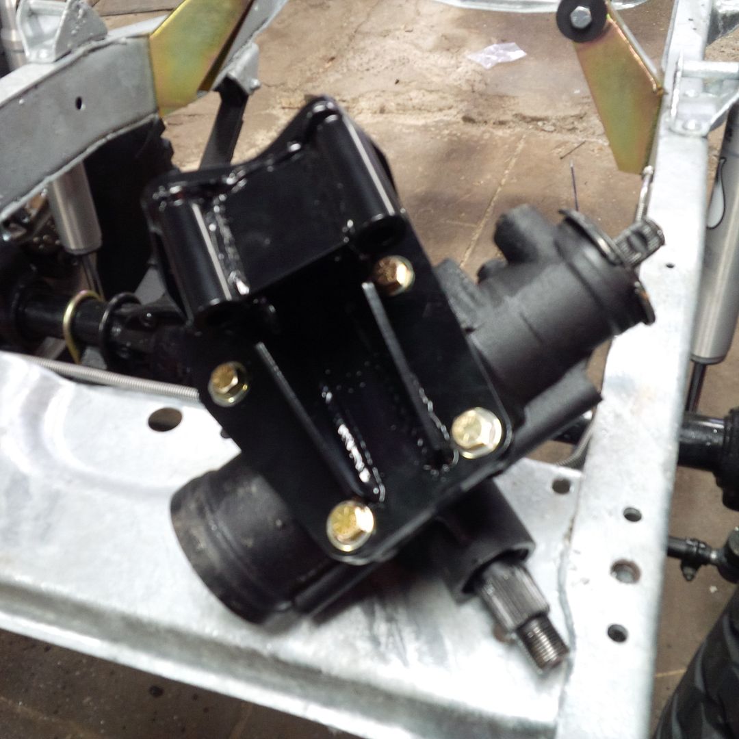

« Reply #236 on: January 19, 2014, 07:58:52 PM »
tackled steering this weekend..
Box mounted on new bracket..
Steering box brace mounted...
Missing Pitman arm nut... so all progress kinda halted here..
