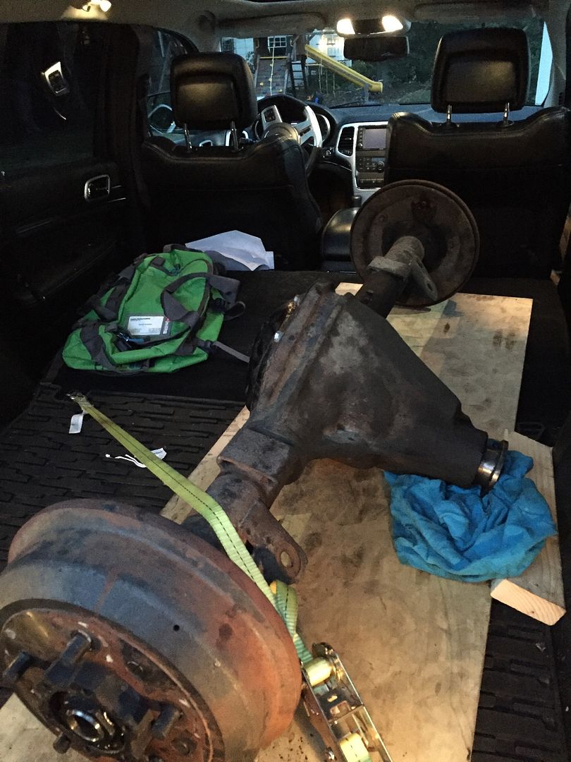

really???
I'm taking it out of the truck.. easier to deal with and it only took 45 min to disassemble..
felt like i needed to do something last night
its a Dana 60 center section as far as this is concerned..
bearings no problem, seals no problem..
gear set and carrier are different but interchangeable..
issue is, no 4.7:1 ratio for a "Dana 60"  and yoke is different
doing some homework today to see what options are..
