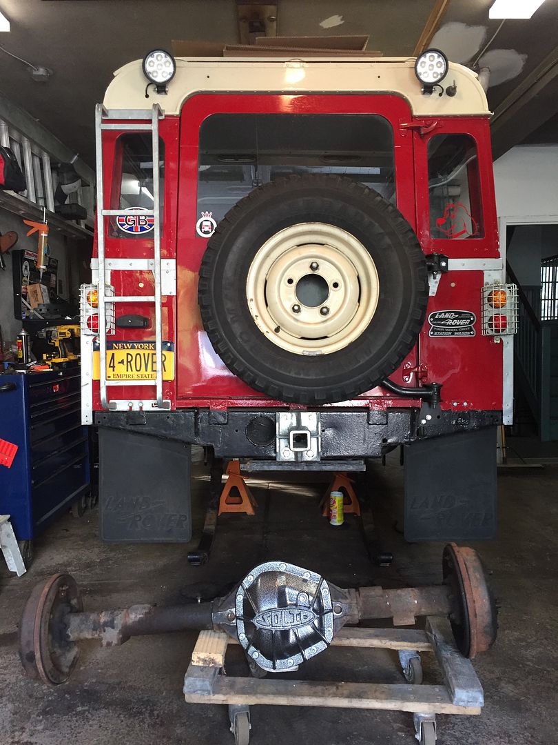

While the rear axle is out I picked up a new rear hose, made some brakes pipes, and am in the process of painting the various brackets.
It all went down hill when for some reason I decided to remove the rear shackles from the frame mounts.
Needless to say Im 1/4 of the way in on the rear frame bushings.
Chewed the rubber out of one and have to grab the air hammer tomorrow.... Hopefully these won't hold me up.
This wasn't exactly the way I envisioned spending time with the truck...
Re: Land Rover 109
« Reply #211 on: September 27, 2016, 10:06:18 PM »
Old bushings chewed and knocked out, new plolurathane ones to match the front installed...
shackles painted and new SOLID cover arrived.
Waiting on LR brake parts and a call on actual axle :-\

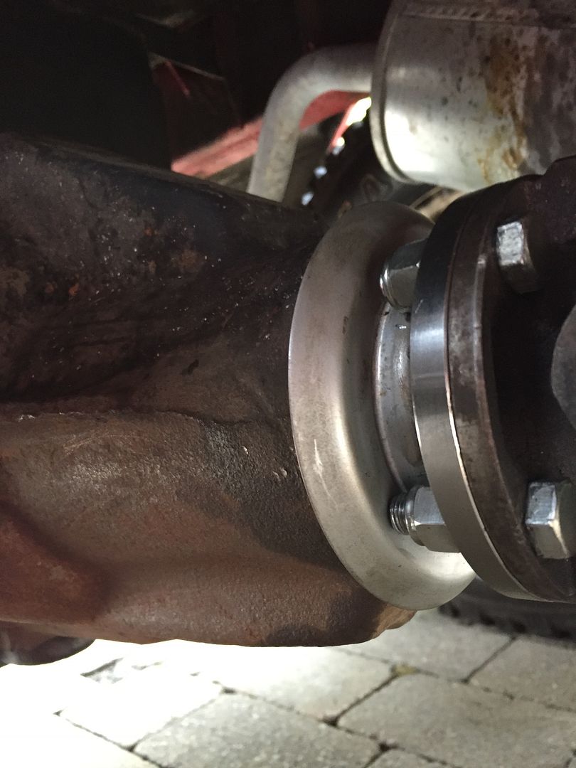

Picked up the axle yesterday afternoon and got it all settled in the truck last night..
little bit of bearing and race drama I was thankfully able to solve..
I guess the Brits shim this carrier on the bearing side of the race, not the cast iron side..
thankfully Timken makes both American and British "D60" races.. just took a little digging..
some exterior upgrades to keep it full of oil and hopefully leak free, included an updated pinion flange from a defender..
2 hrs. soup to nuts, including a quick on the lift run in...

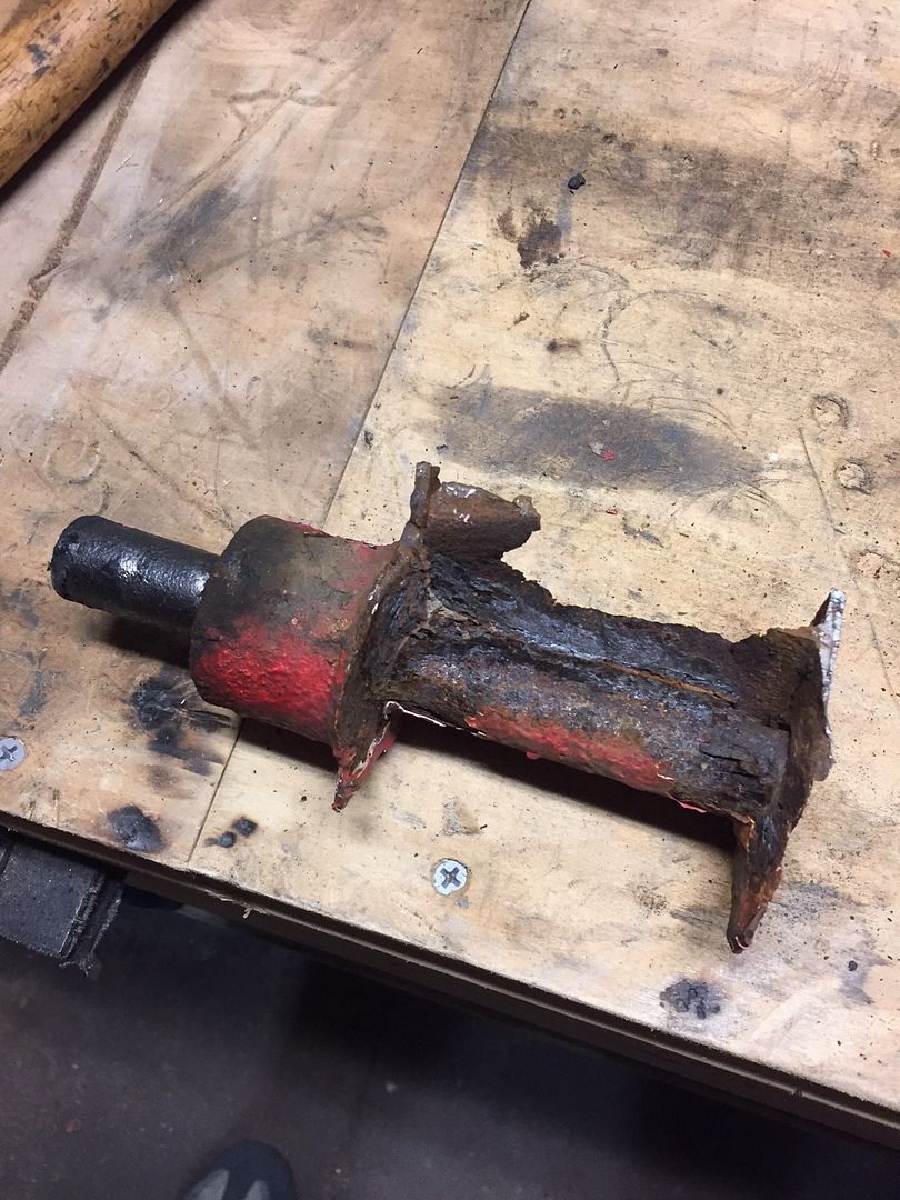

broke the rear upper shock mount this AM..
going to have to drive home and evaluate later... :'(
Re: Land Rover 109
« Reply #216 on: November 09, 2016, 09:20:47 AM »
Broke clean off...
still DD status for the moment..

Re: Land Rover 109
« Reply #217 on: November 09, 2016, 10:25:06 AM »
Mmmm crusty
Sent from my SM-N920V using Tapatalk
Re: Land Rover 109
« Reply #218 on: November 09, 2016, 10:51:25 AM »
yeah..  but frame isn't punky there at all..
I think I either need an M4 shock location redesign or to go back to some "stocker" gas shocks..

« Reply #219 on: November 09, 2016, 09:17:25 PM »
needs less bush mechanic welds

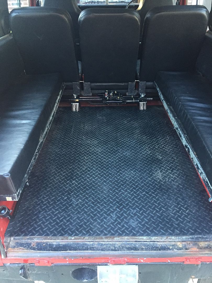

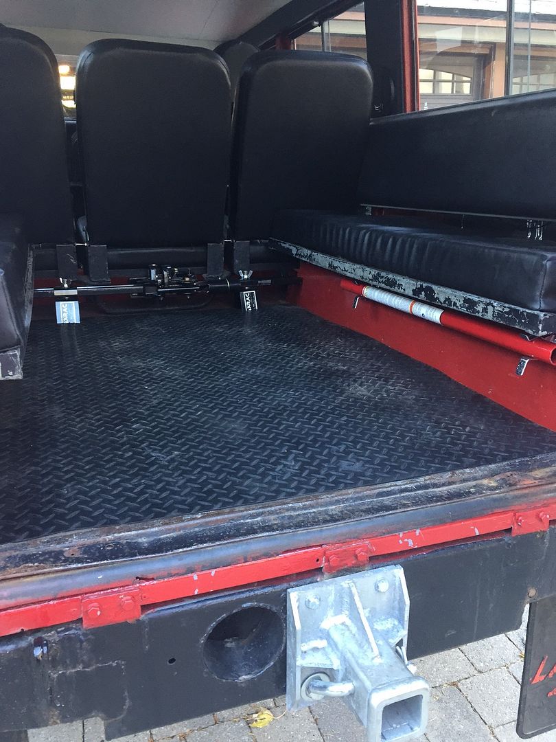

Finally got a jack permanently mounted in the rover.
baby hi-lift fit perfectly behind 2nd row, handle mounted out of load space.
Its just enough to do a roadside tore change..

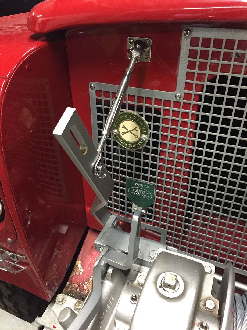

installed an anti mistake mechanism on the koenig...
now that the driveshaft is in, I have been cautious of walker byers that might have fiddled with the controls.

Re: Land Rover 109
« Reply #223 on: November 19, 2016, 02:59:18 PM »
Smart.
