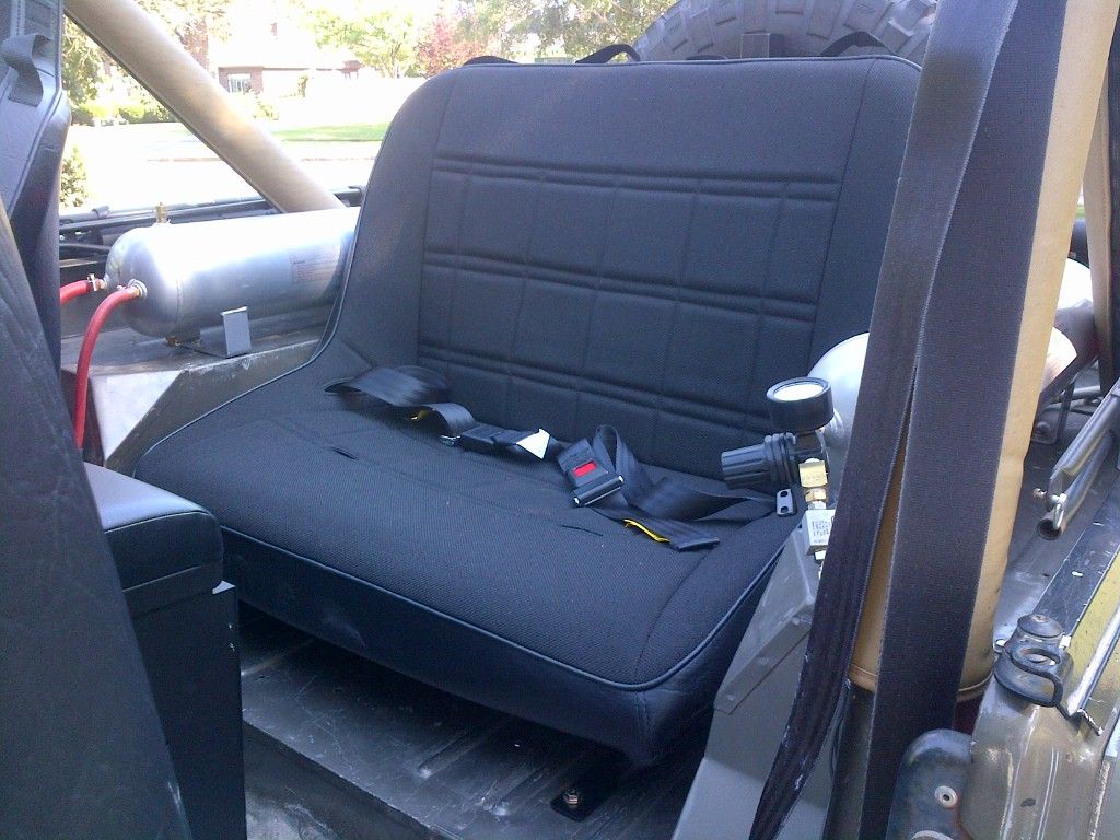

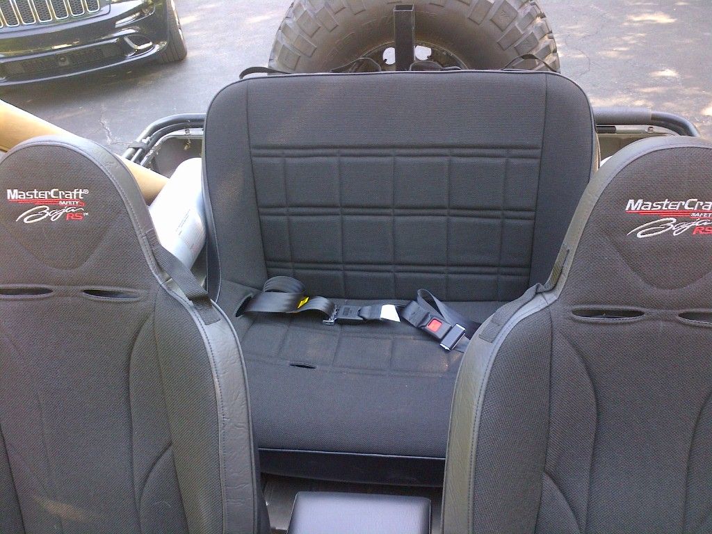

Rear seat installed as well.. fits nicely in the stock mounting locations...
have to re check my storage boxes and possibly buy new ones if they dont fit...
