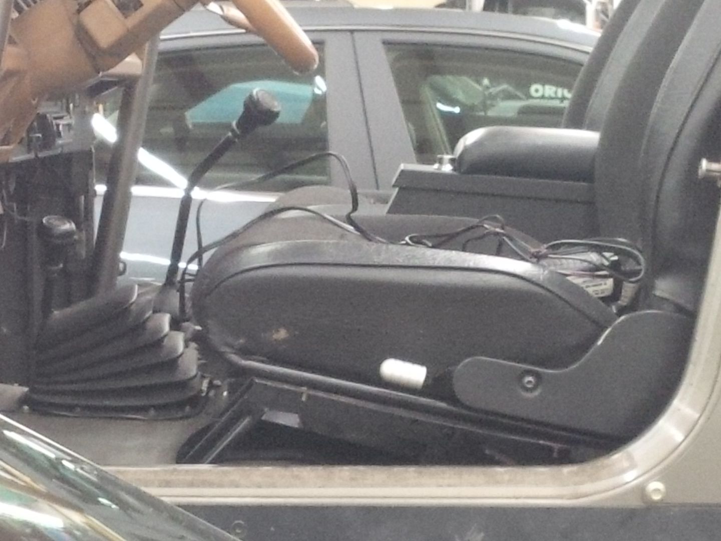

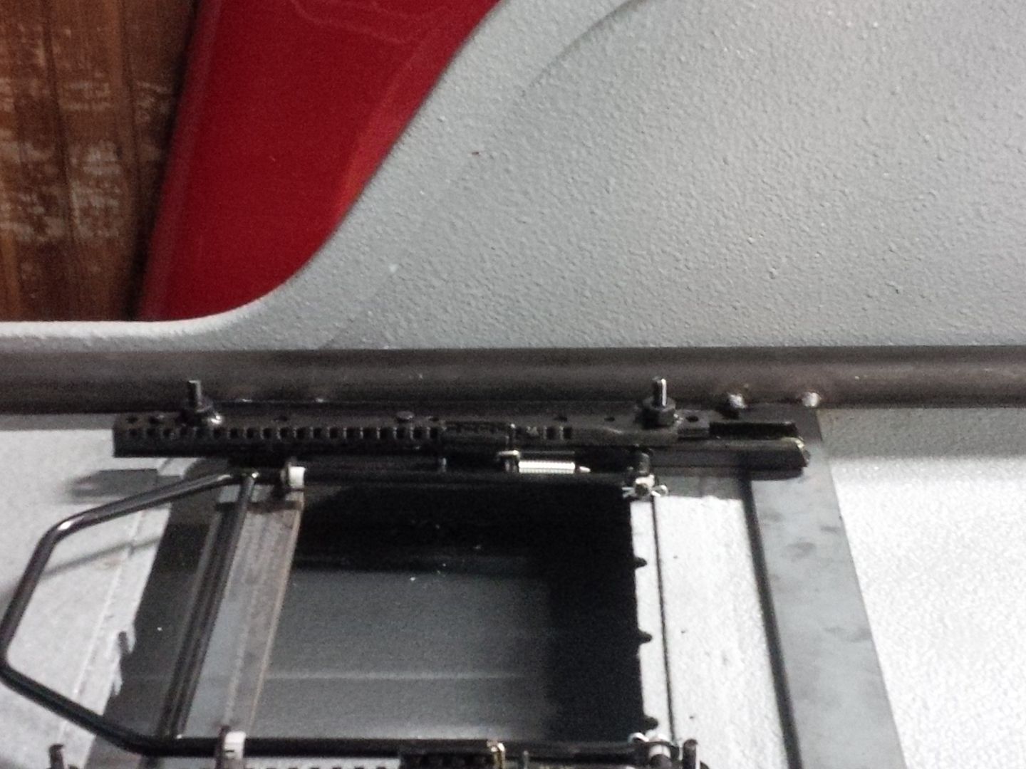

id feel comfortable with another 1" or so for me.  maybe its good.  at the very least throw some padding on it.
short of pulling sliders to get back 1.5" not sure besides different seats like we did with eds.
« Reply #557 on: December 09, 2014, 07:46:12 AM »
I think I might have found an extra inch....
Have more time to spend on it when LR get the hell out of my way...

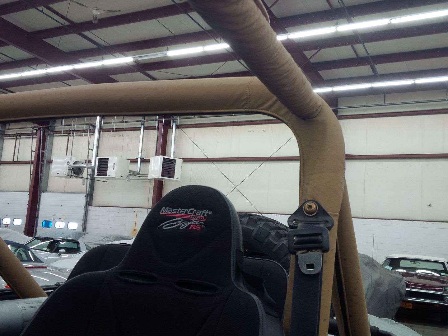

« Reply #558 on: December 09, 2014, 09:28:51 AM »
was up at the warehouse this AM and noticed the seast in my YJ...
I think with a decent rake instead of being flat mounted on floor, Might be able to grab another inch or so..
Im also going to grab one of the fiberglass doors I have to mark on the tub where the door jam/top begins..
My YJ doesn't have sliders, but it has a wider door opening..
  • Posts: 23286
« Reply #559 on: December 09, 2014, 09:32:12 AM »
rake isnt going to help unless the floor goes away in the back

just for reference later...
Quote from: jeepermc;1181963
Approximately 44.25 from floor to top of b pillar. 1.25 from top of tube to the lowest point on the top
