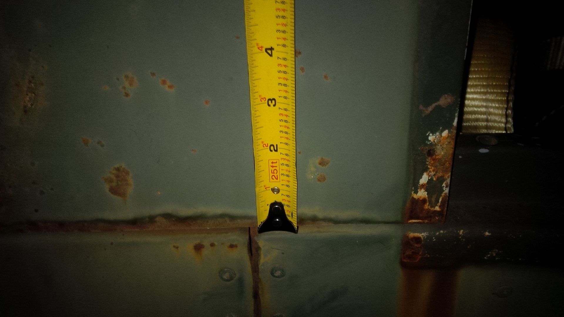

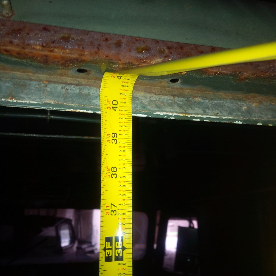

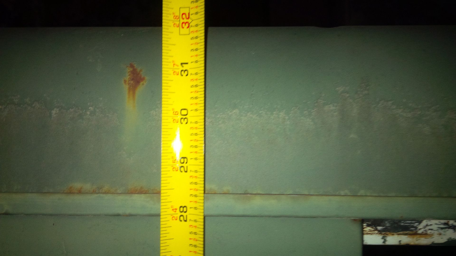

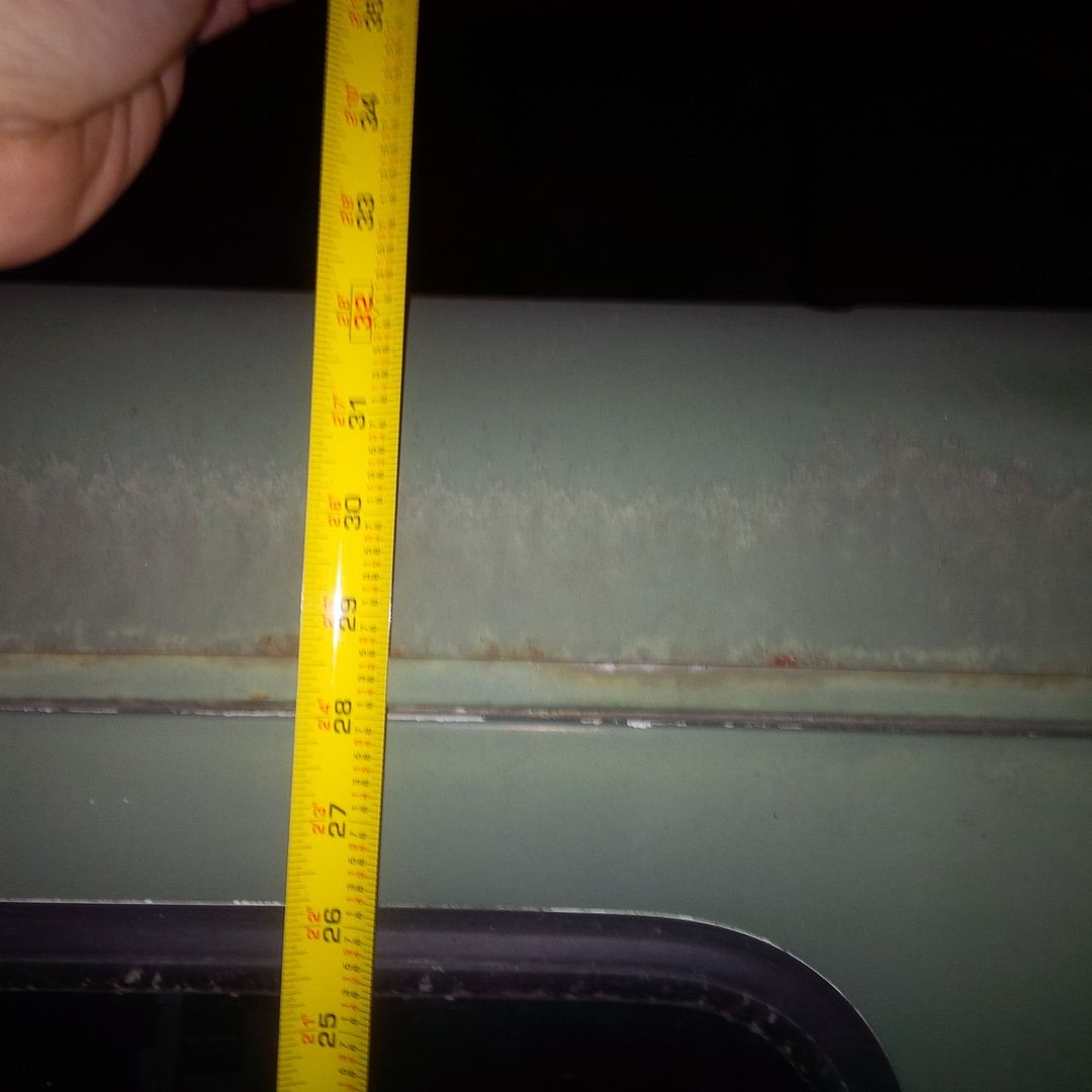

need that measurement from the side rail to the middle hoop and the rear hoop also like we talked
« Reply #508 on: November 28, 2014, 10:41:33 AM »
The 4.3 work well, Had them in the Profender buggy for the Kids, and I think Gif has them in his buggy.
http://prpseats.com/product/4-2-harness/
« Reply #509 on: November 28, 2014, 12:50:42 PM »
no roll bar in the truck....
from rail to rain gutter on hard top is 28"
measured from here... right by door opening
total height of roof from side rail is 32"
from rear of load floor to opening of rear door is 40.5
