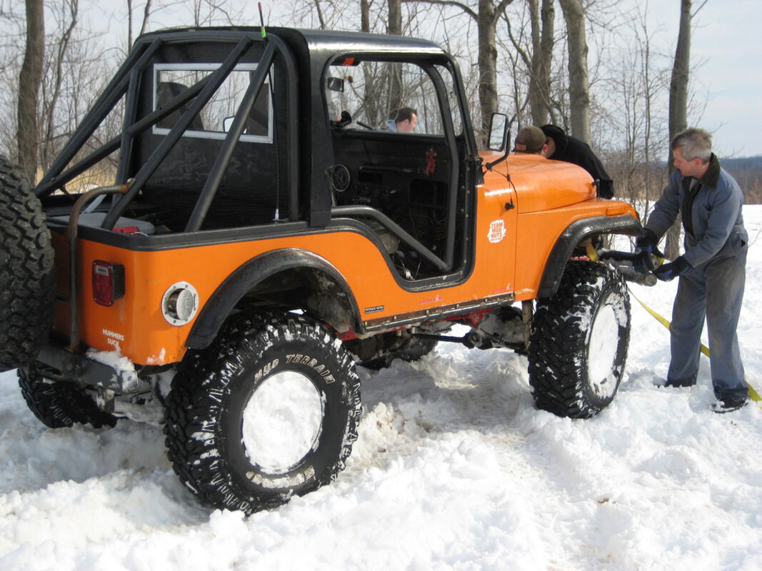

« Reply #278 on: February 13, 2014, 09:23:30 AM »
who says I dont already have a half cab....

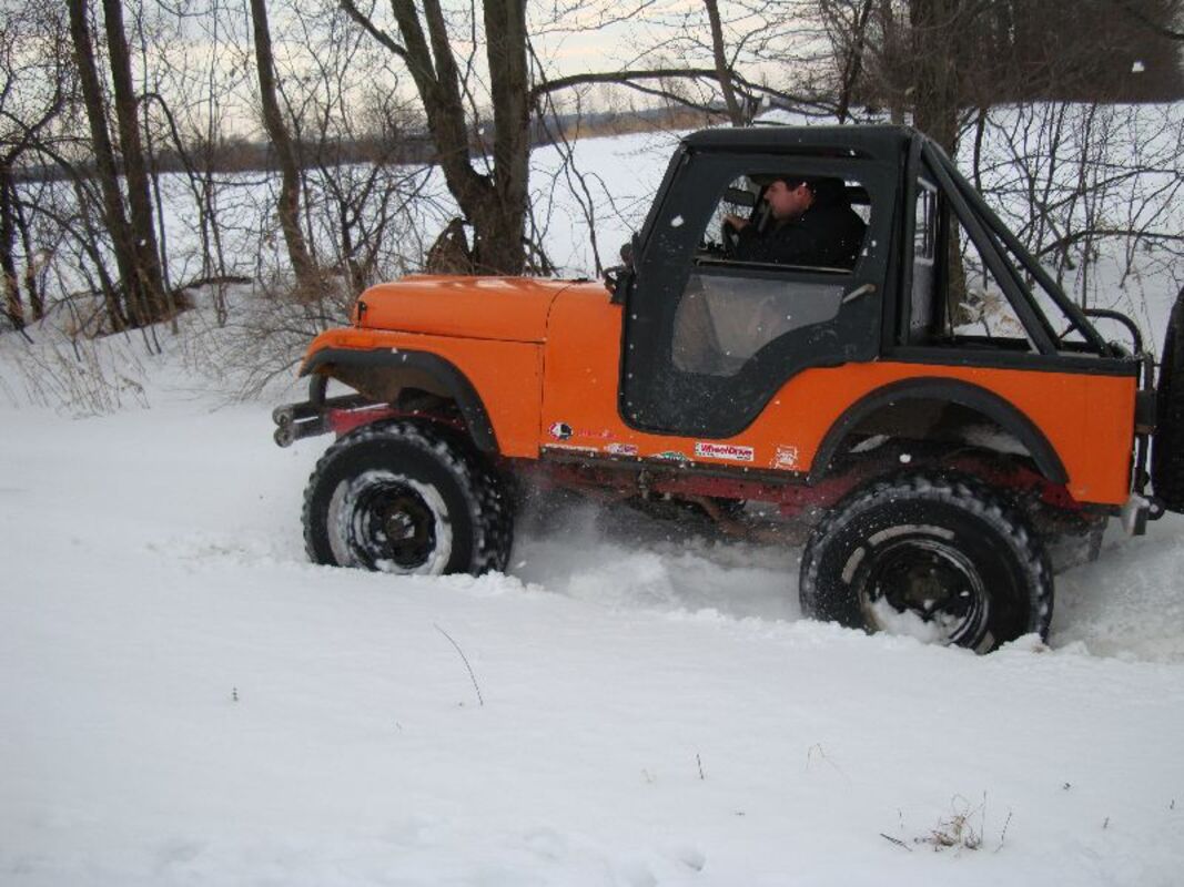

« Reply #279 on: February 13, 2014, 09:27:07 AM »
i like this better :)

« Reply #280 on: February 13, 2014, 09:30:27 AM »
I was talking the whole jeep.
« Reply #281 on: February 13, 2014, 09:31:14 AM »
light years away from tops...
I’ve actually contacted these guys about a custom top..
http://www.rallytops.com/
fiberglass is so much easier than steel... and it won’t corrode the body..
« Reply #282 on: February 13, 2014, 09:31:59 AM »
yeah i know.. i dont pay crazy money for completed things.. just for things i might never complete..
