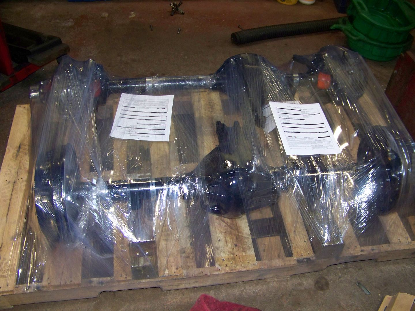

D30 Front..
3.73 gears
ARB locker, 30 spline
RCV 30 spline shafts
Moog and Wagner chassis and brake parts
Rebuild with all new Timken bearings and Seals...
1982 CJ7 disk brake knuckles w/yukon HD spindles
Superwinch premium lockout hubs.
« Reply #181 on: December 01, 2013, 04:01:47 PM »
One of these is not like the others/ One of these just doesn't belong.
Options are pretty limited unless you go to a unit bearing though, right? There was no D30 internal locking hub? With the ARB I'd probably just run drive flanges with grade 9 bolts. I'm recalling the external lockout issues that were had on other rigs here with bolts loosening and breaking. Wasn't that Ryan's scout 44 front that also had unending spindle bolt issues as well?
« Reply #182 on: December 01, 2013, 04:44:03 PM »
nope..
30 spline inners
27 spline outer..
didnt want to go 30 outer for 2 reasons..
 1. availability of spares..
 2. wanted to make the weak link be the outer stub that is more easily fixed on trail...
     one spare stub, lockout, spindle will work for both sides..
there are 30 spline lockouts and a 30 spline stub available...  gives me something to upgrade to :)
« Reply #183 on: December 01, 2013, 06:23:55 PM »
Yea, mine broke many times, I believe Cora had issues with hers as well.
« Reply #184 on: December 02, 2013, 09:37:38 AM »
i broke lots of hubs and then ring gears
