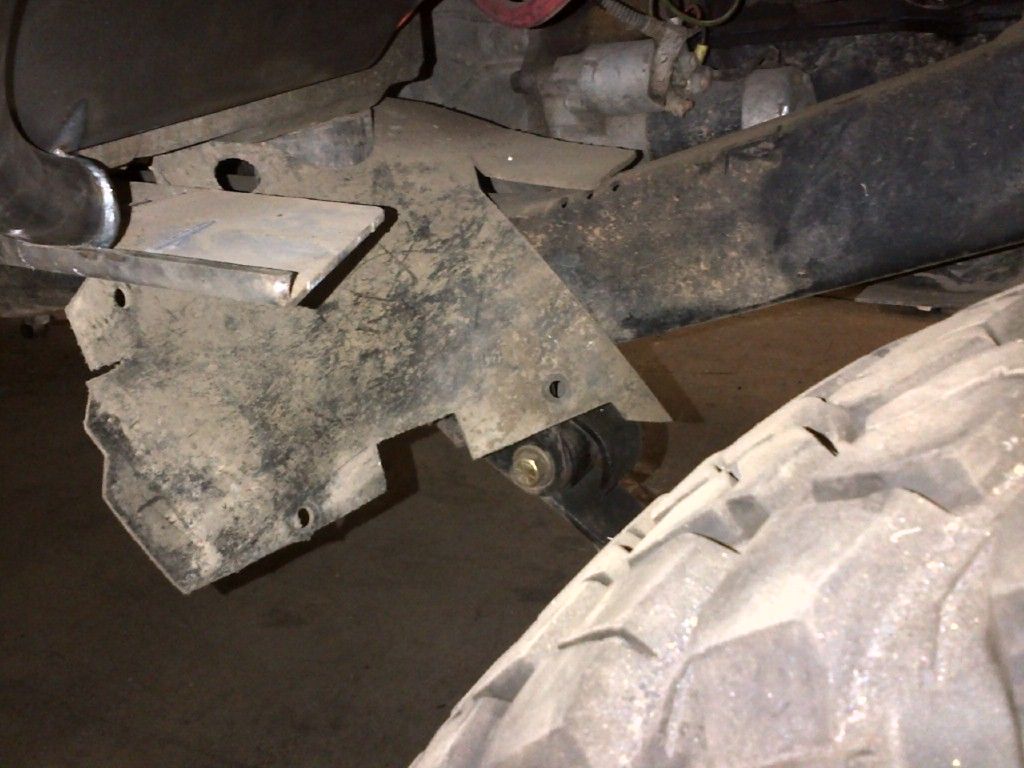

I eliminated the claws of doom... no more getting hung up on stumps and rocks...
still need to trim them down..

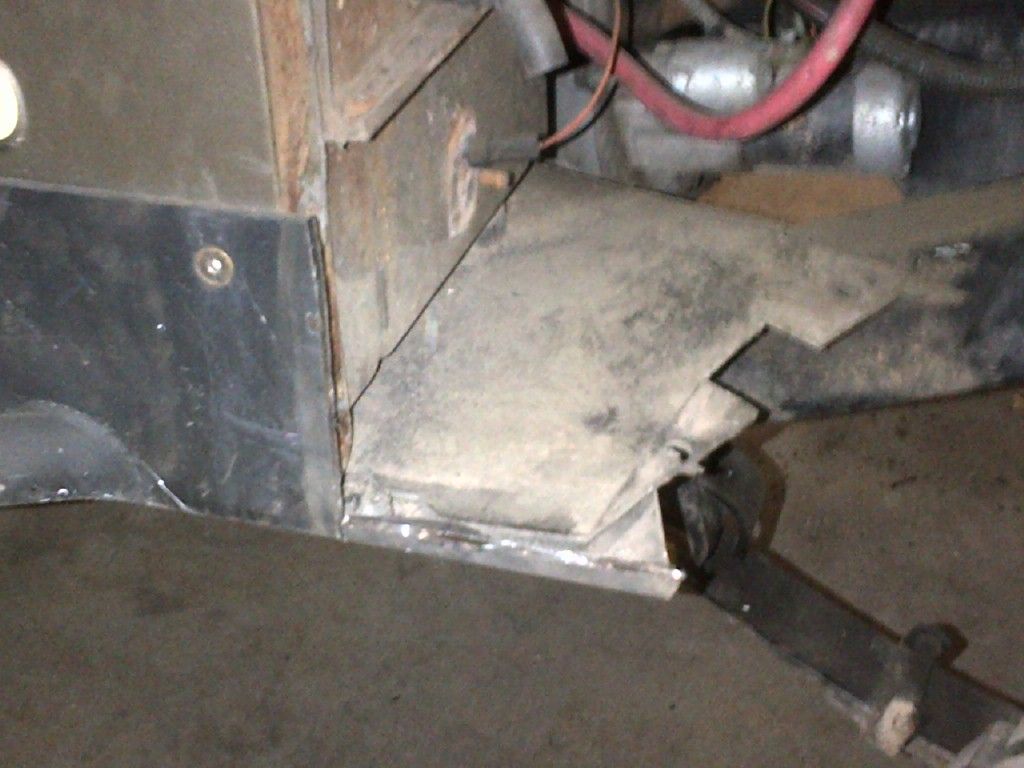

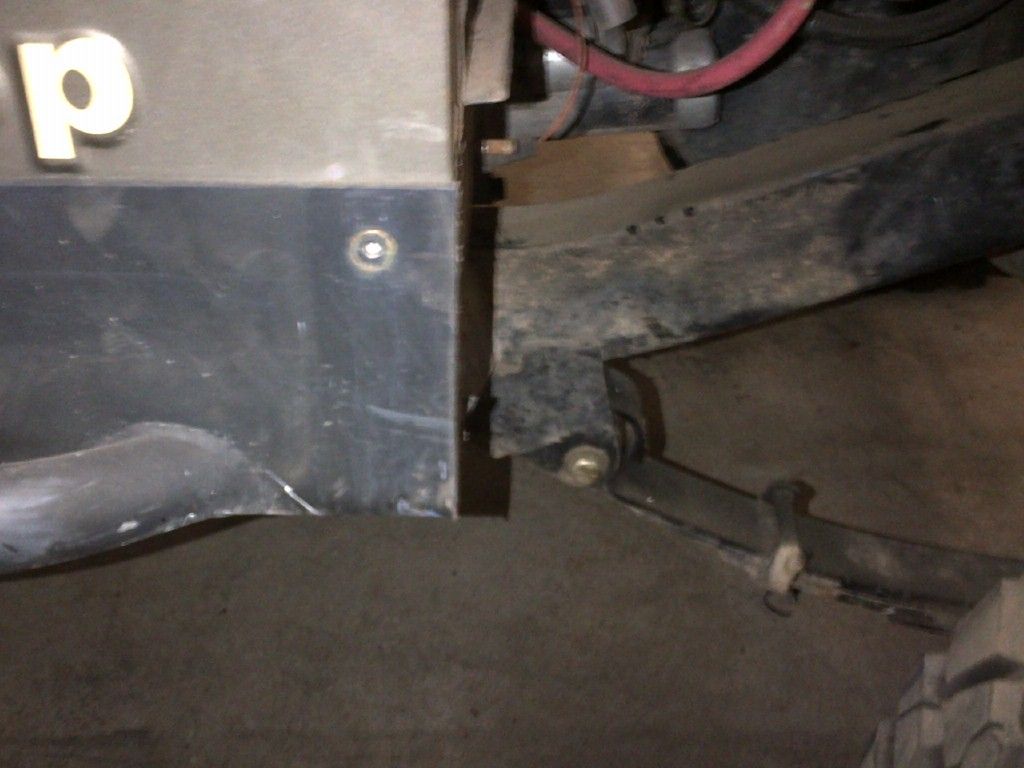

Cut the front portion of the slider to mock up the fender...
went easy with the 4.5" cut-off.. going to go in and clean it up with the saw and wheel.. going to have to remove the horizontal portion as well and make it flush with the tub.
Passenger fender mocked up..
and the issue with the bottom portion..
looks like the 2" body lift is deff going away and stock rubber mounts will be put back into place...  wheel openings are THAT much bigger..

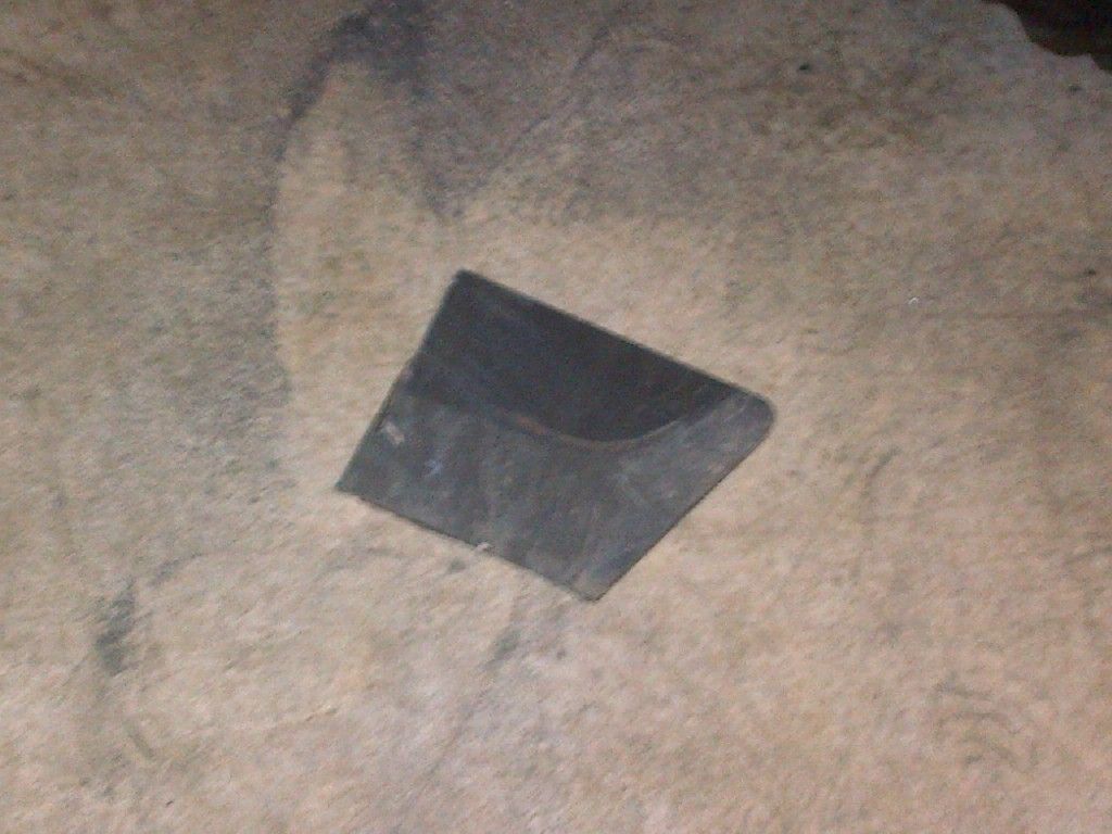

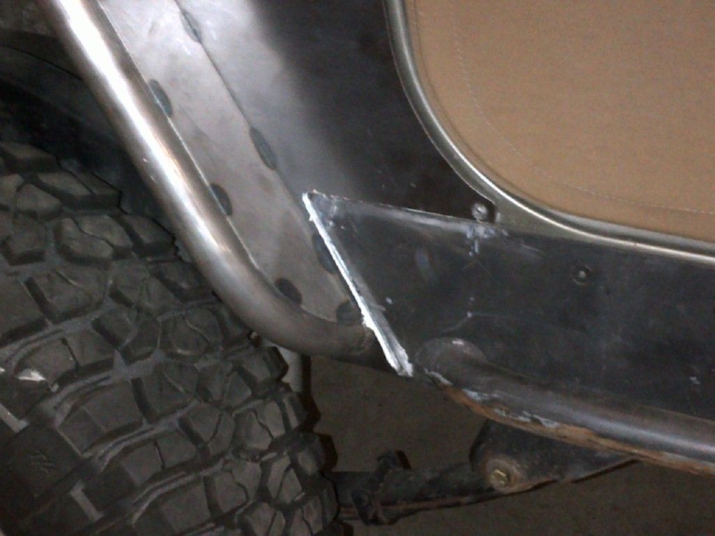

spent some more time today with the YJ under the knife... or cut off wheel....
Front section of the sliders cut nice... flush with the body tub...
T square and some blue tape made for easy work..

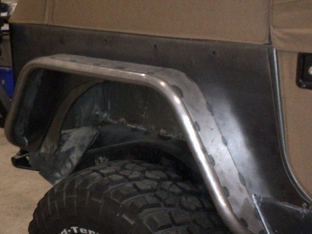

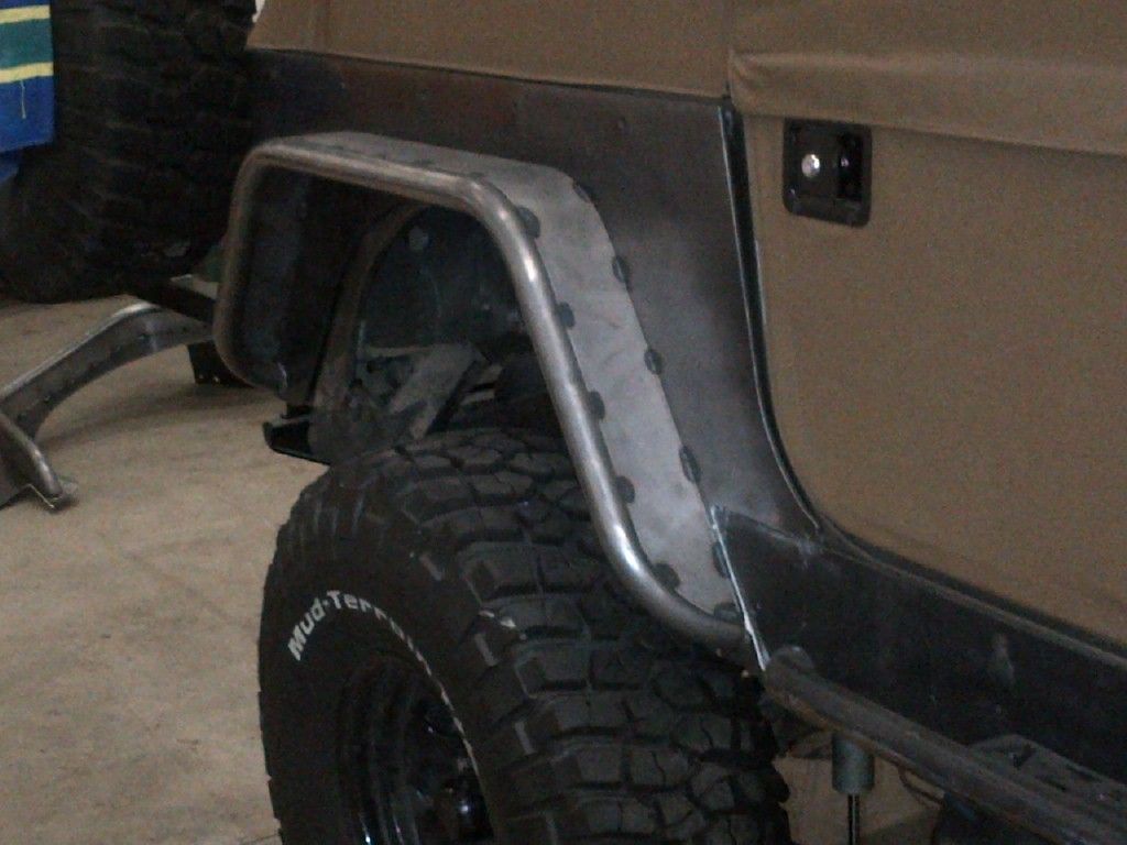

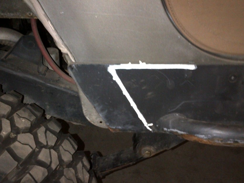

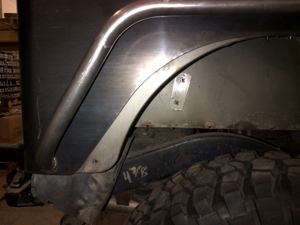

went to go mock up the rears and there was a bit of an issue...
the rear portion of the AtoZ sliders extend way beyond where the TnT corners mount.
A few marks with a tire pencil and some surgical cutting with the grinder and I had a rough outline.
a few trail and error fitments and I finally had it snugged up where it needs to be..
and yes.. nicked the body in a few places, but nothing more than a scratch... little seam sealer and POR and good as new..
In hindsight im glad i didnt take the sliders off.  These actually are a fit as you go kind of product..
assuming I didnt have the AtoZ sliders and perhaps the TnT brand or none it would have been an easier job..
Passenger side is all done.. Ready to drill the holes for the mounting hardware and drop off for paint next week.

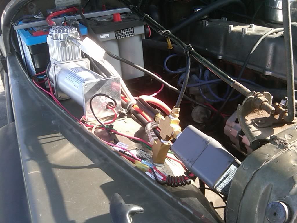

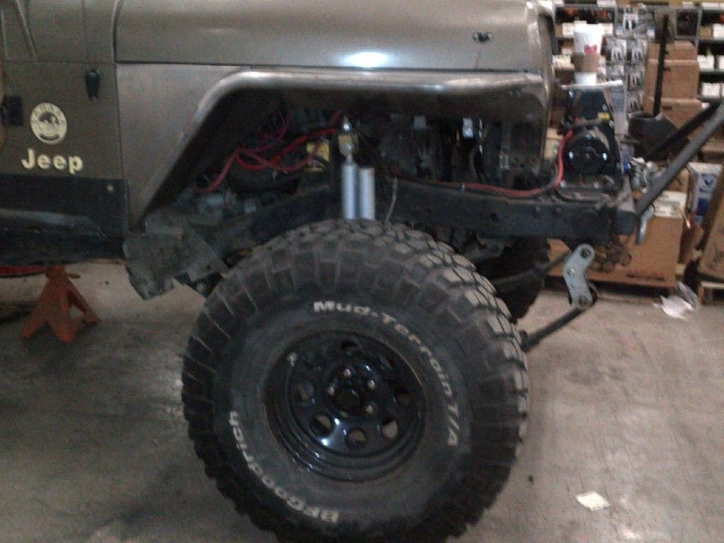

I was up at the warehouse yesterday and looking at this thing...
I think I may have decided to go back to a single battery while keeping the dual battery tray.
I think with the decreased inner fender space it might be wise to mount the compressor on the battery tray..
Still undecided.. it might be able to fit under the battery tray, but then it opens itself up to the elements...
« Reply #74 on: March 06, 2012, 10:35:09 AM »
here is a good shot from the old thread when I finished the install.
The battery tray is HUGE.. would make a nice flat platform to mount the compressor.
I think the winch/compressor was the reason why I opted for more juice..
I also feel like it had something to do with the FI system… but I have since found the REAL cause of the problem..
Once I get the new fenders mounted I will get a better idea of how much room I have under there to mount the compressor..
