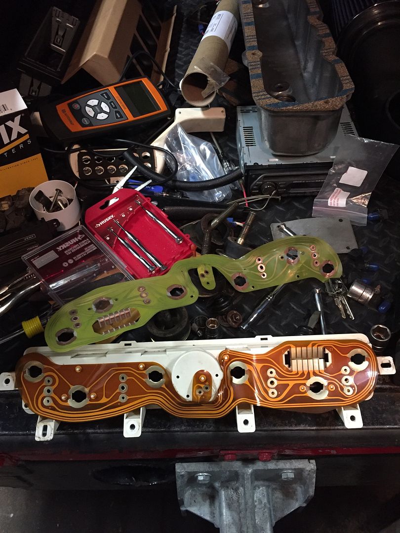

Re: rescuing an old friend
« Reply #410 on: September 25, 2016, 08:56:20 PM »
Some weekend work while waiting for new prom...
- Valve cover resealed
- gauge pod back together
- fuel lines will need to be rerouted
Temp gauge still inoperable... New sending unit tests ok, ordered a new gauge
Ran engine to operating temp and no leak from back of valve cover..
Not happy with where fuel line is.  I feel it's getting cinched between body and frame.
Pulled it ontop of frame in wheel well to have unrestricted flow..
