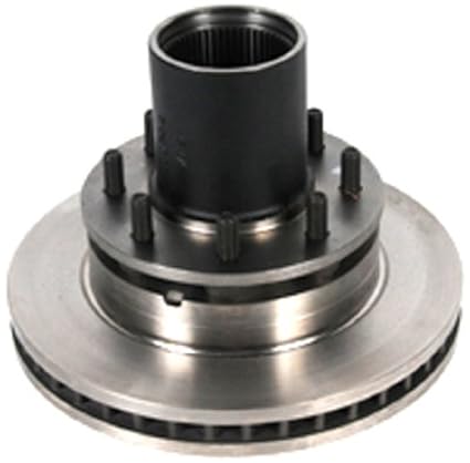

Re: Willys MB build
« Reply #205 on: April 29, 2014, 08:11:45 AM »
Arie sourced these for me.  Not cheap but do-able.
  • Posts: 2205
Re: Willys MB build
« Reply #206 on: April 29, 2014, 08:37:05 AM »
that is redonk cheap!
  • Posts: 15919
Re: Willys MB build
« Reply #207 on: April 29, 2014, 09:21:09 AM »
$150 ea WITH studs and a rotor? Mad crazy cheap. I can't believe those aren't twice the price with the way used SRW stuff goes. I'd almost pick up a pair for stock so I have SRW outers if ever needed, like for Mule with other parts I already have laying around.
  • Posts: 23282
Re: Willys MB build
« Reply #208 on: April 29, 2014, 09:28:52 AM »
ya that is crazy cheap.
