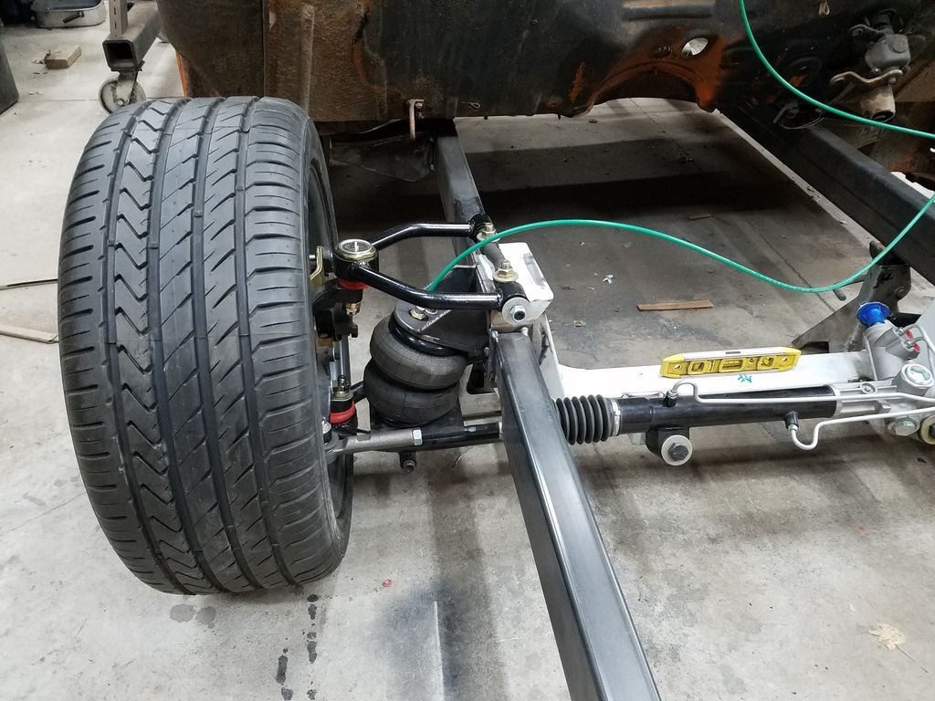

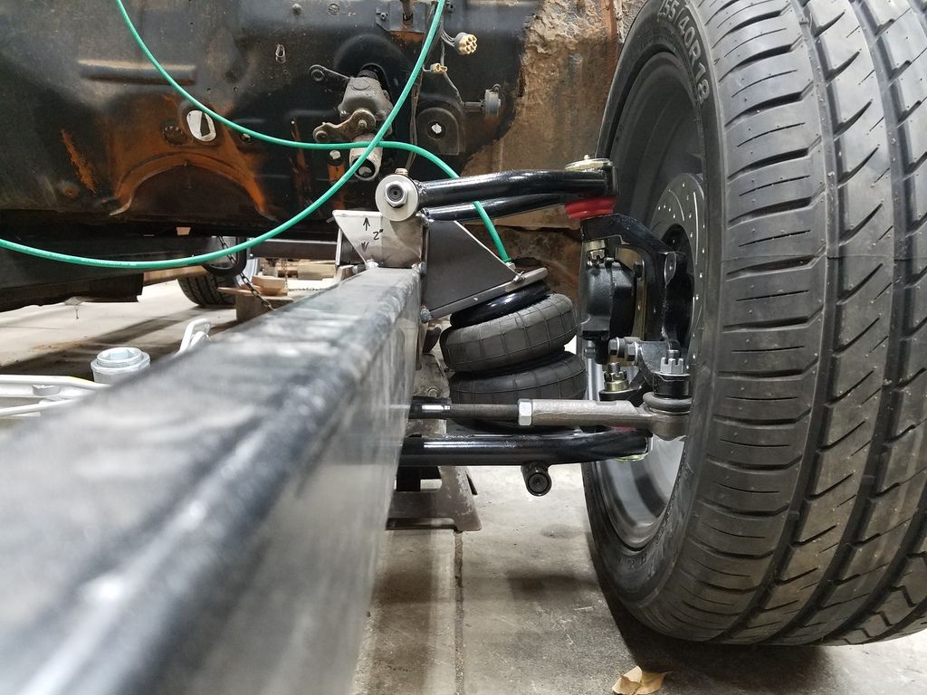

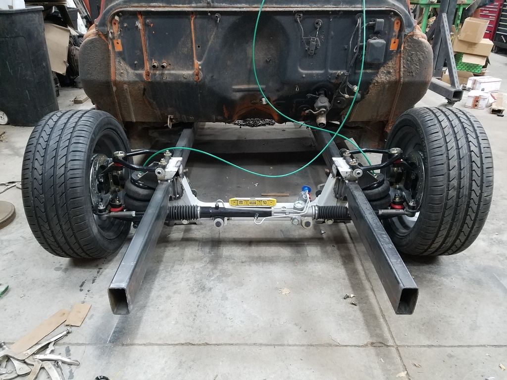

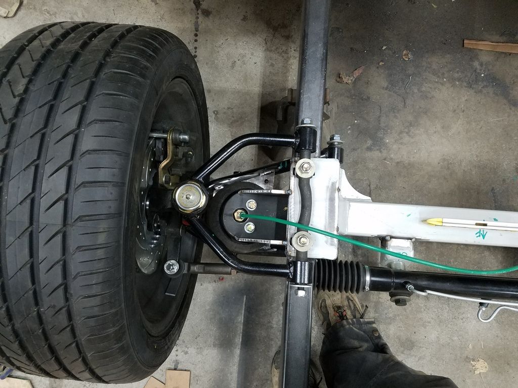

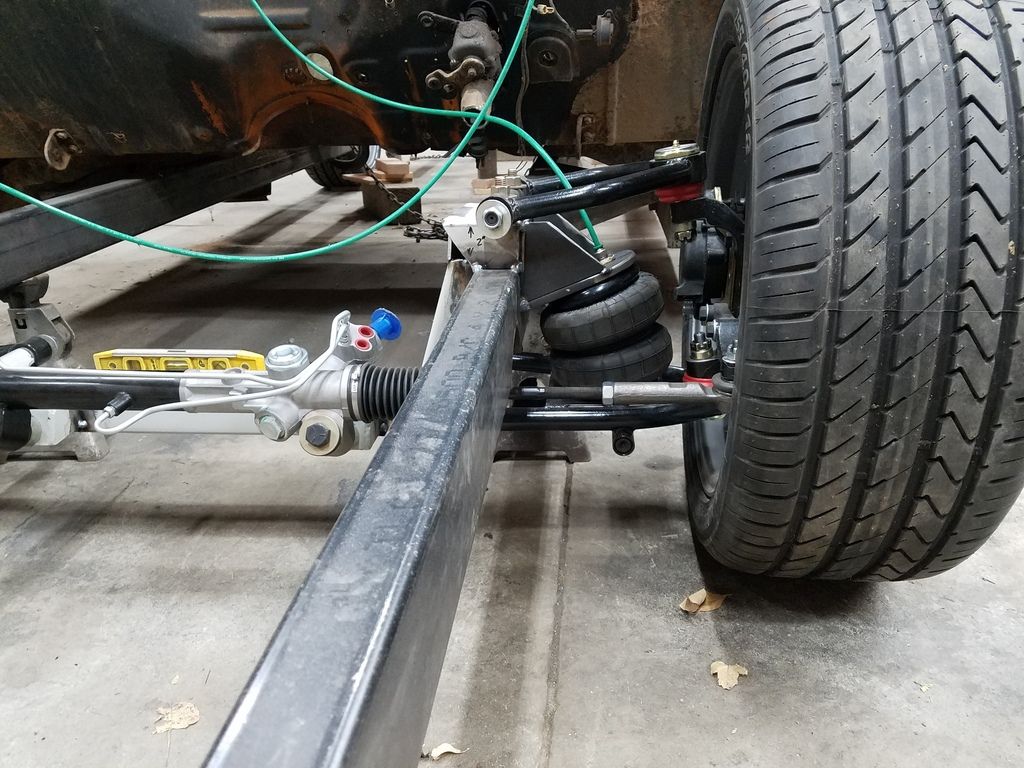

Front air bags installed.
I didn't like the placement of the air bag with the provided brackets, so I made my own.
Had to cut out the upper hats to make room for the brackets i made.
This keeps the bags away from anything that might rub.
Air bags have internal bump stops, but i think i might add some external hard stop bump stops just for an extra added safety factor.
At full deflation everything still sits 1" off the ground.
Spent some time sifting through the Monroe shock catalog to find shocks that meet my requirements. In order of relevance, mounting style/stroke/size/cost.  Shocks ordered.
Pics are at normal ride height.
« Last Edit: March 02, 2020, 01:13:42 PM by gif »
