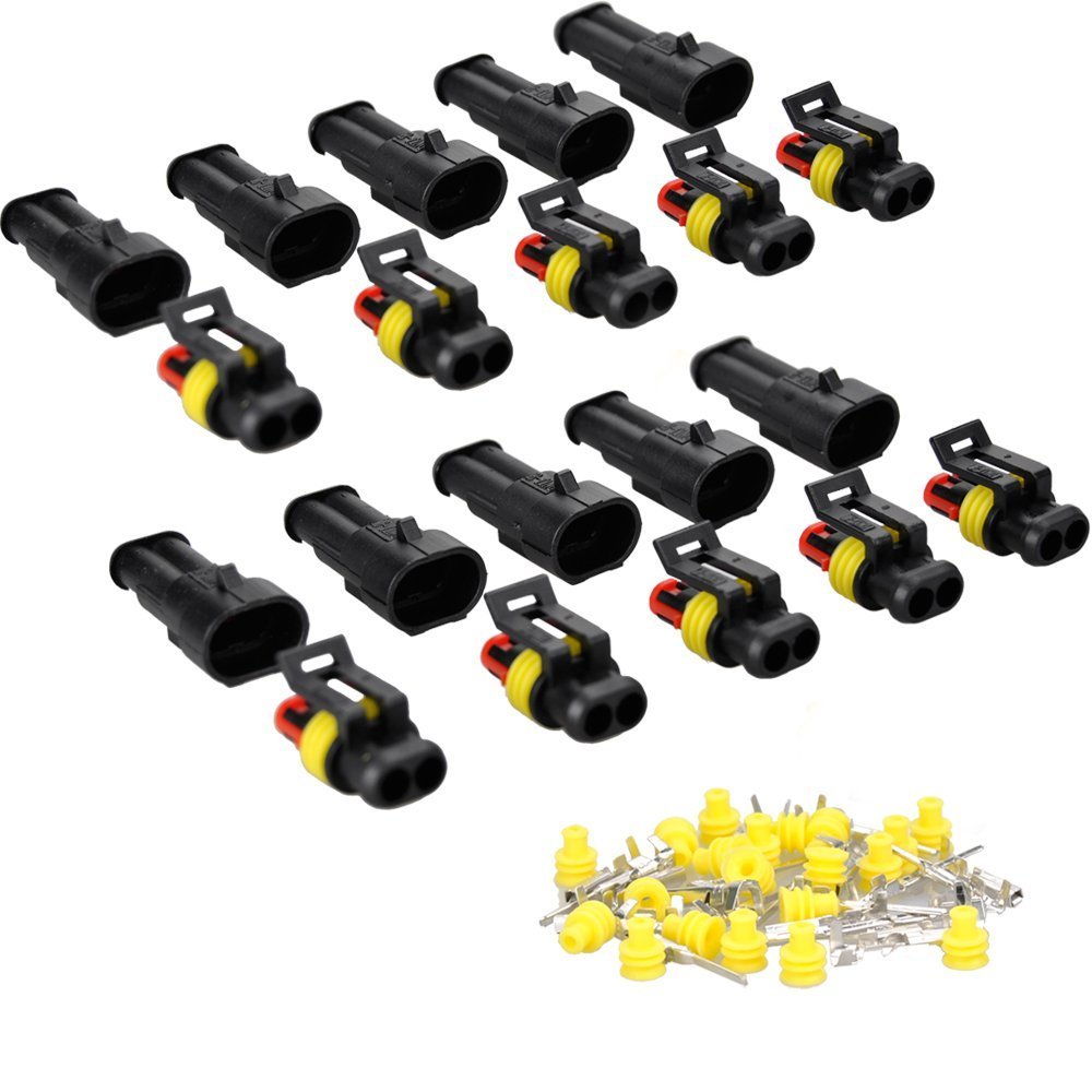

I can make something water-proof AND nuke-proof but at the same time I don't want to as that'll turn it into a project and require big budget haha.
I think these outdoor weather tight grey boxes and conduits will work well for me as I have TON of room underneath, along with this kit.
https://www.amazon.com/Good-done-Waterproof-Electrical-Connector/dp/B01N4L7T51/ref=sr_1_11?ie=UTF8&qid=1501704349&sr=8-11&keywords=sealed+2+wire+connector

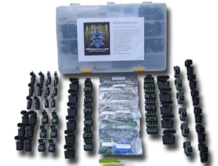

the more I think about it, the more I don't want to run ANY conduits. Dirt collecting inside conduits can cause problems (unless somehow perfectly sealed) and make any repairs more difficult.
I am thinking to run wires (preferably jacketed) and use Delphi Packard weather pack connectors at all components (brakes, lights, etc.) all hanging wires (at brakes, lights, etc.) will be sleeved with either wire looms or braided sleeves for additional protection. I'm thinking about wires running down the trailer will be either secured with loop clamps every 12"-18" or weld in a long 1/2" round stock along the trailer on one side and zip tie all wiring to it.

There's many different weather-pack connectors available. I narrowed it down to Metri-Pack 480 series because they're the only ones I find that's designed to fit 10 gauge wires and good quality (not some China junk). I'm going to run 10ga wires to brakes. I most likely will go 14-16ga wires for lights.
