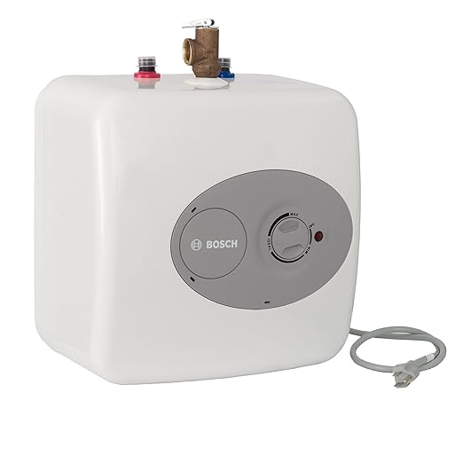

Replacing the water heater.
Looking at getting tankless one to save energy and space. also eliminates the need for any venting though the chimney that currently does not have a liner in it.
Any experience with something like this?

Use that combined with a small under-counter electric and it will be bliss. The tankless units need a bit of flow rate to kick on and then there is a slightly longer delay while the water gets heated as opposed to just getting through the pipes. If you combine that with a little 110v under-cabinet electric, you can get instant hot water for the little jobs like hand washing and endless hot water for the showers.

I was thinking something like this:
https://www.amazon.com/Bosch-2-7-Gallon-Electric-Mini-Tank-Heater/dp/B0148O658Y/ref=sr_1_1?ie=UTF8&qid=1480432770&sr=8-1&keywords=under+sink+water+heater

same what i found, they have 3500watt units on google with 3 year warranty for 69$
need legit power as they draw 27 amps at 120V though could be down fall / install expense.

November 29, 2016, 10:48:44 AM »
Seems like less of a hurdle when the walls are laid bare to studs.
That seems like an insane 120v draw though, surprised they're not 15a 220.
