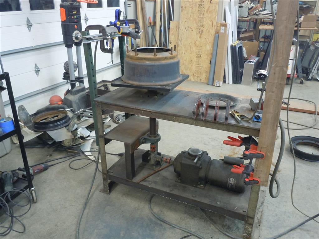

do you know how to fixture an angle grinder, sparky?
Re: F350 knuckle swap
« Reply #32 on: March 13, 2012, 03:04:19 PM »
see if I had this setup sitting around I'd be all set
« Reply #33 on: March 13, 2012, 06:47:14 PM »
That looks like what I used for my rims

Precision! Thought they'd be too tall but it worked great.
