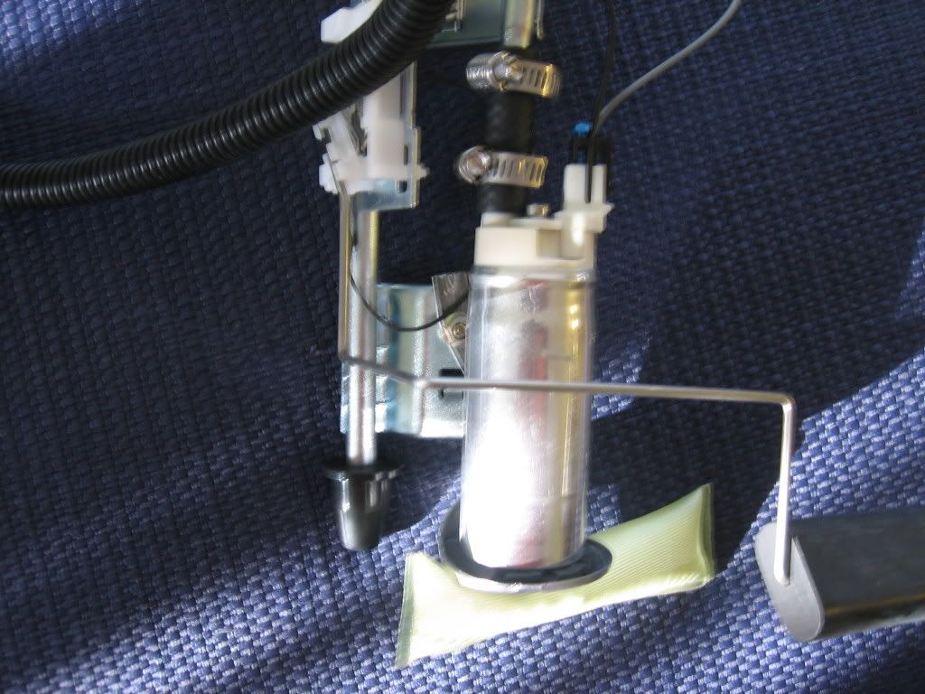

I pulled these old pictures up when I built my in tank pump setup..
only other viable thing I can think of is that the pump is sucking the bottom of the tank and reducing volume, not pressure..  wondering if I have been having this issue since I landed on the tank skid oh so many years ago.. :-X

quick check when i got home..
same high flow WIX on truck as in my hand..
noticed a possible restriction in the supply hose coming from sending unit..
i think there is a groove on the top of the poly tanks where the fuel hose is suppose to curl... mine isn't in there

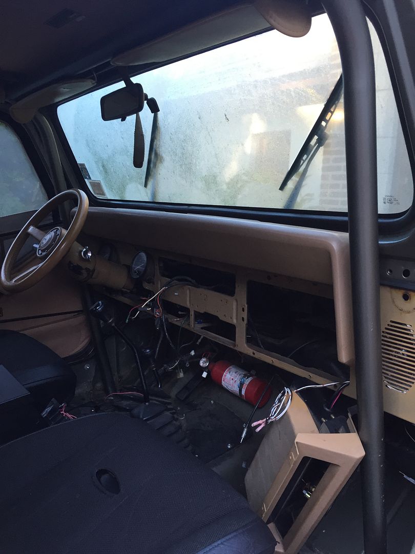

It's also becoming a project.
Elimination of all scotch locks and hack wiring.
Rebuilding the main gauge cluster and dash controls.
Pressure of it being in the driveway is forcing me to keep it moveable.
Everything will function or i'm burning it...
