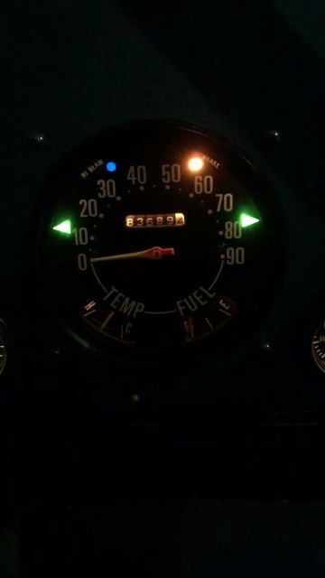

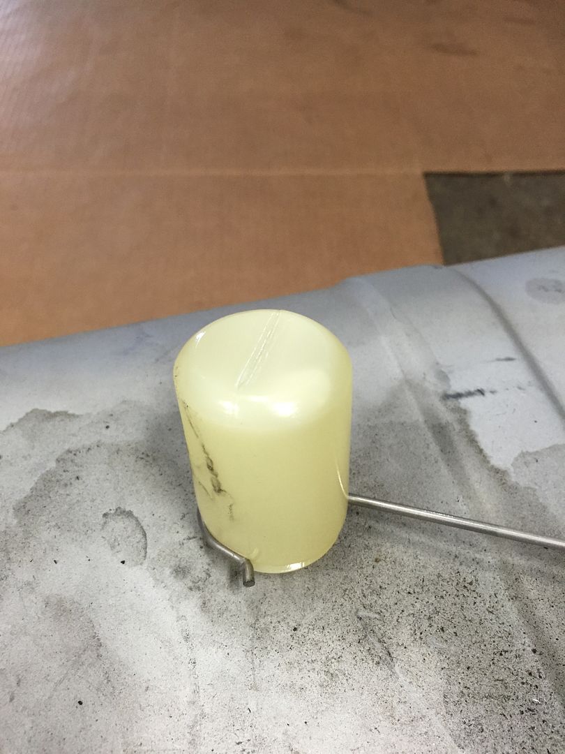

I'm fairly confident this is why my fuel gauge wasn't working..
Gas tank out and in last night..  should have hooked up and fire tonight..

my fuel gauge for what it's worth is fixed....

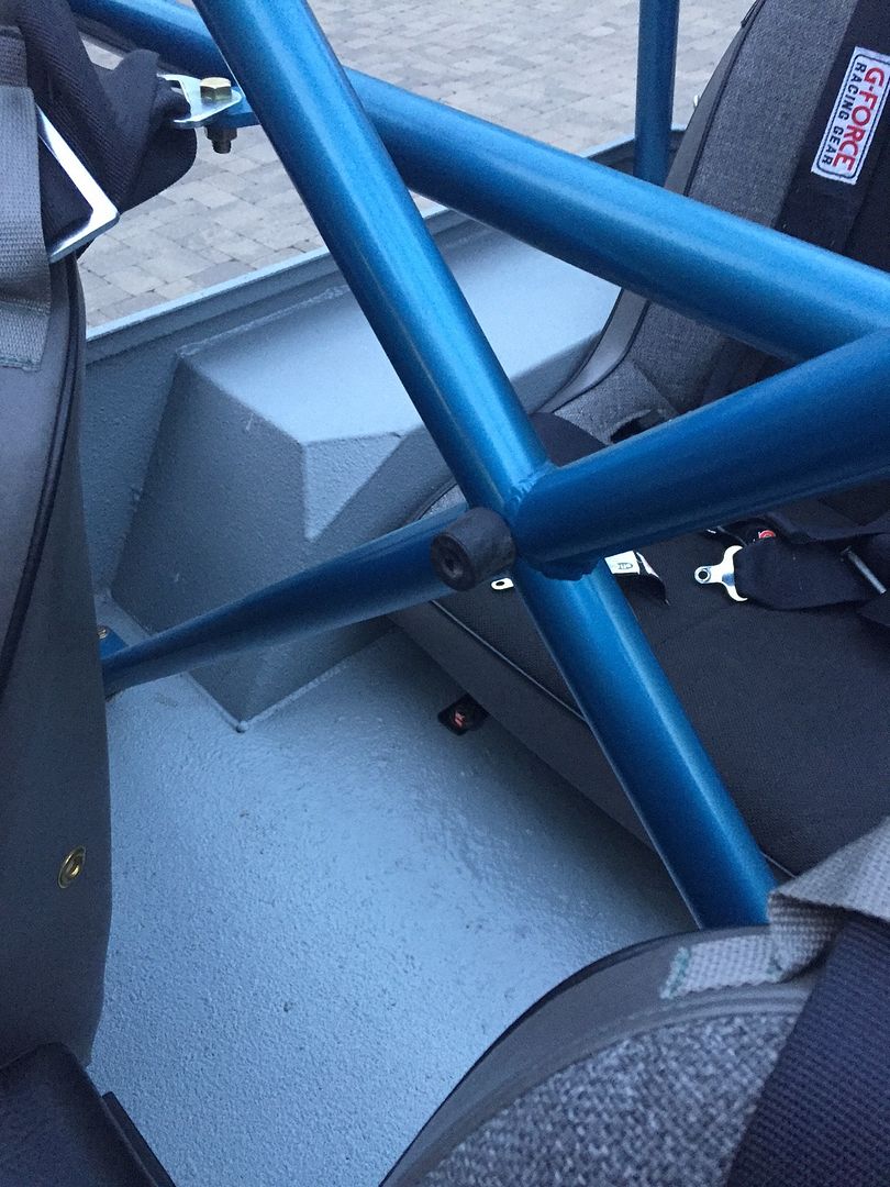

Sweet harness bar

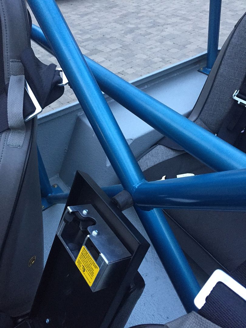

the console lid hitting the cage just had to stop..
