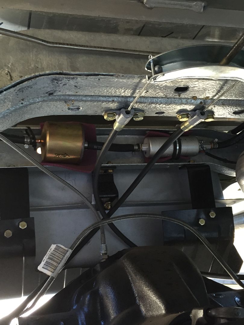

Fuel pump is well out of the way and should have good air flow..
Mounted nice and tight, don't see any BIG issue there...
I am getting some fuel sweat here.  I think this was done with my old flare tool and I might need to re-flare the fittings..
some heat shielding or fuel line insulation here is prob a must..

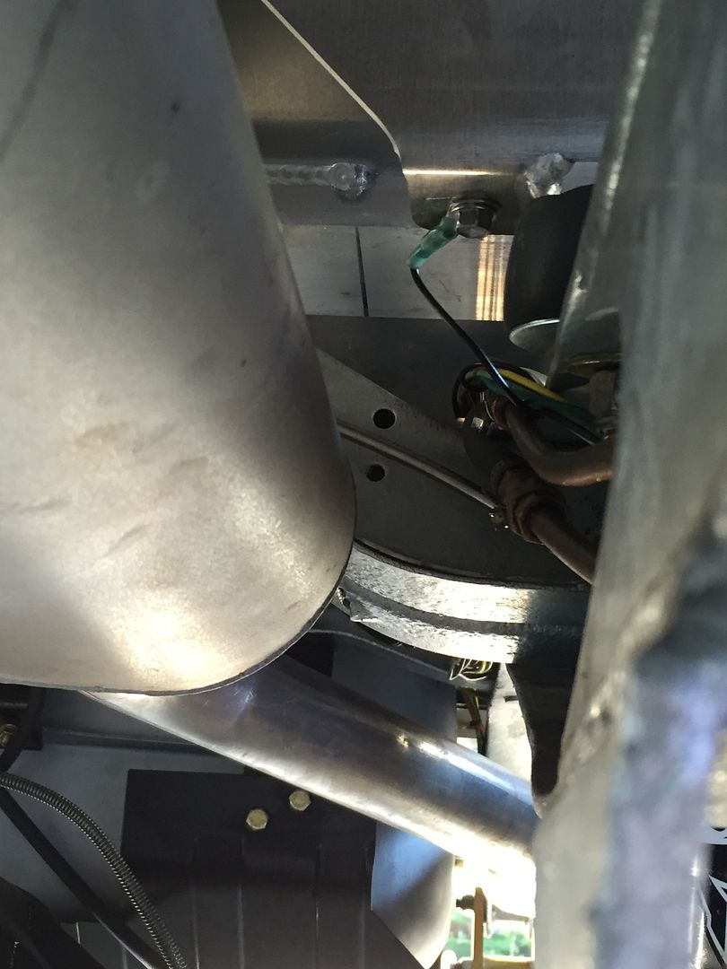

« Reply #672 on: August 06, 2015, 09:03:41 AM »
...update...
ran 2 vent lines up into the wheel well and zip tied to the turn signal...
No further staling issues...
Vapor canister and check valve next...
