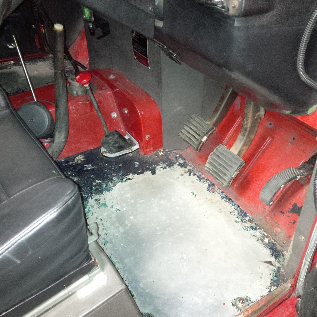

Its rust inhibitor system is working a bit too well right now. While I'm in there some "tiding" also needs to be done.  Really hope to get this in and out in short order..
Drained the coolant at a gas station last night and dragged it home via tow rope..
Backed into garage and:
1. removed tire
2. removed hood
3. removed floor matt (all 50 lbs of it)
Would like to get engine out and on stand by Sunday...

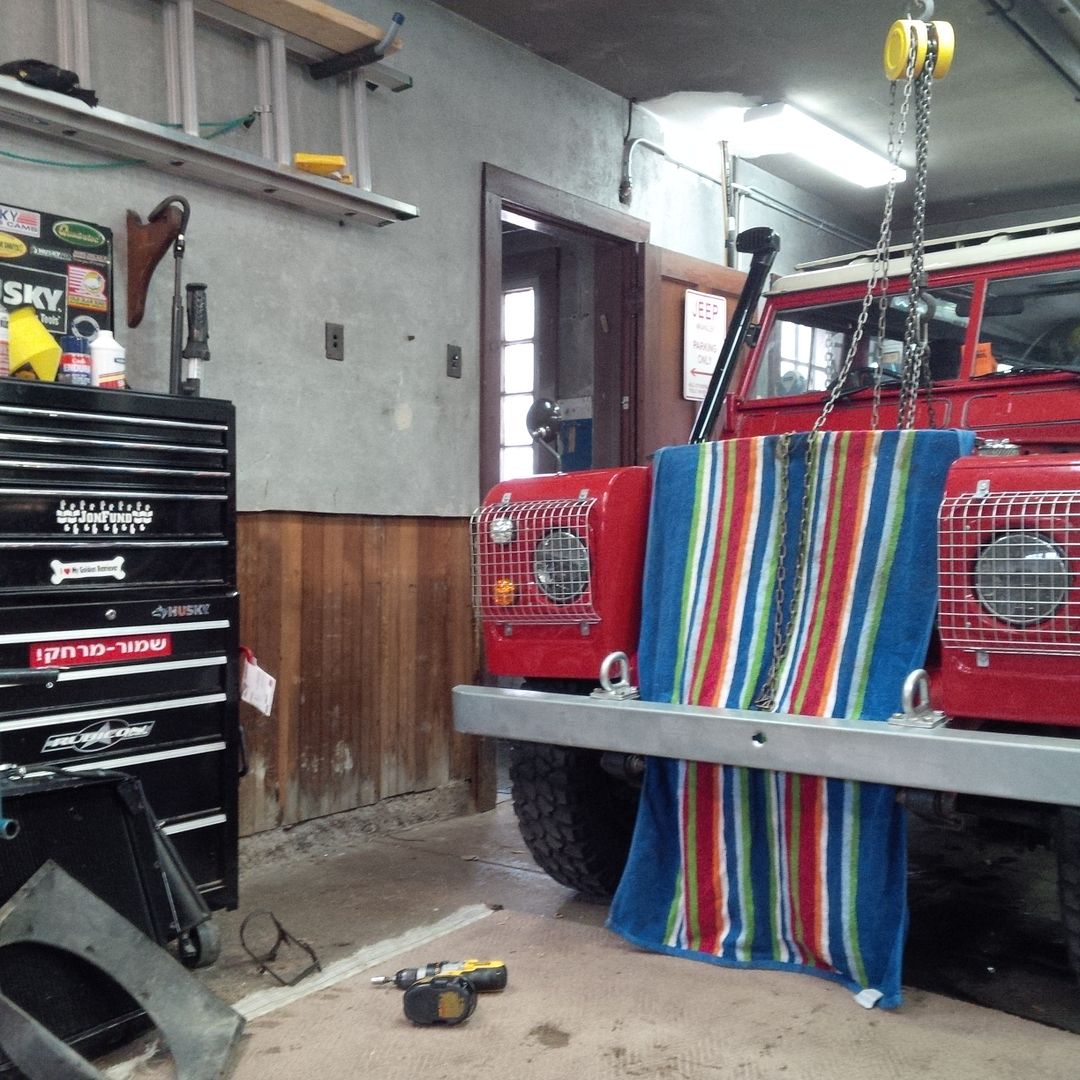

« Reply #107 on: November 16, 2014, 10:04:28 AM »
waiting for my 3 yr olds friend to actually yank the motor..
had it free yesterday afternoon..
to do's are adding up as I look at the truck more and more  ::)

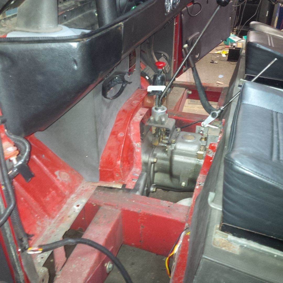

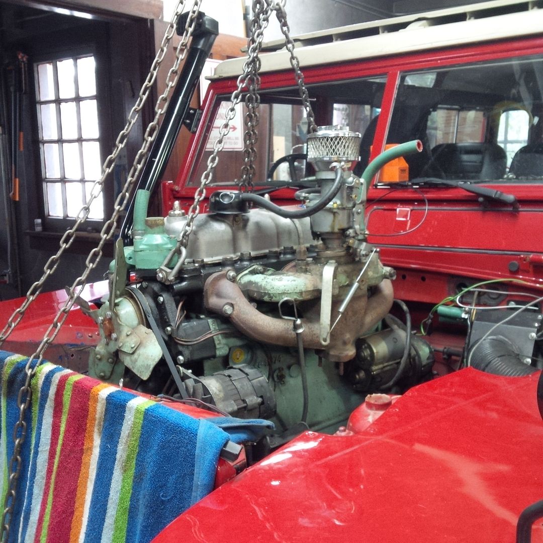

I also noticed there was no good step by step write-up on doing a 2.25 RMS..
I think I might compile all this in some good order once its done for a resource.
Started Saturday when the kids went down for a nap..
able to finish it all up when my oldest woke up and he helped operate the chain fall for me..
front floor and trans tunnel removed..

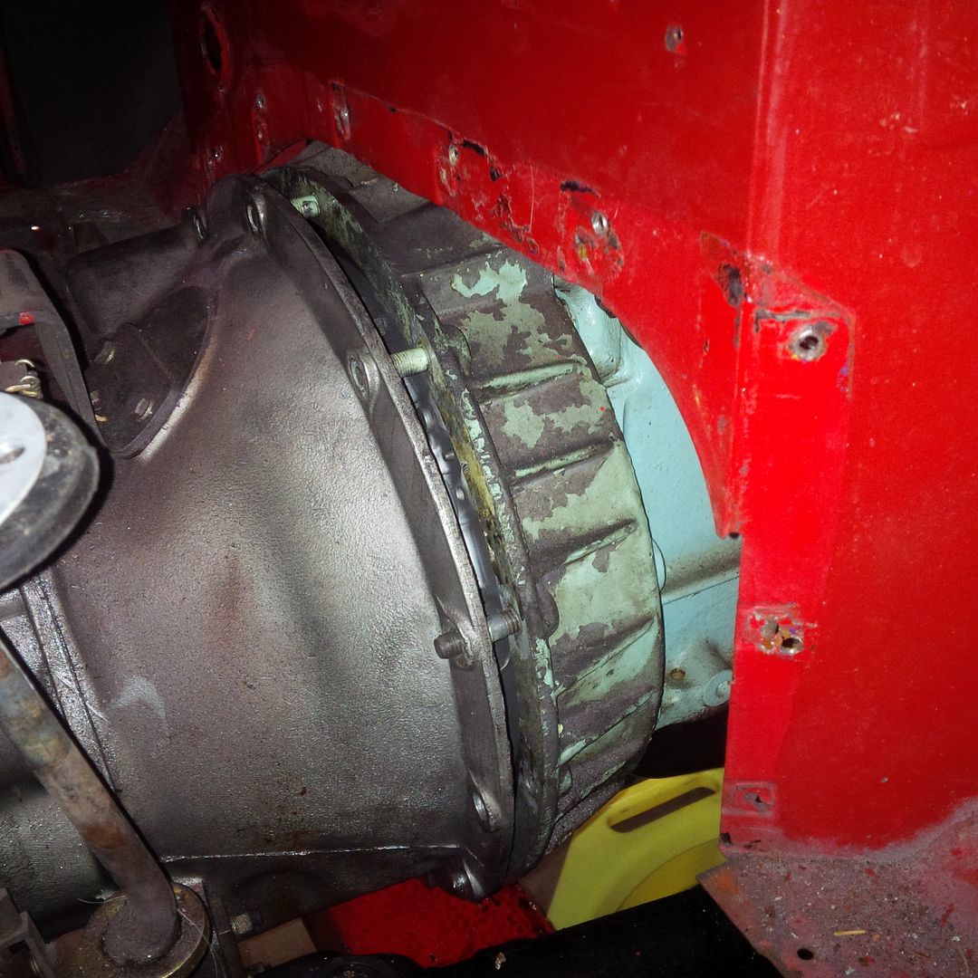

Hello flywheel housing bolts..  no wobble sockets or greasy forearms :)
Engine disconnected and chained..
speedo cable needs to be replaced, was a bit damaged from exhaust
have a nice little setup here, and the heater keeping up well.
we have lift off and separation..

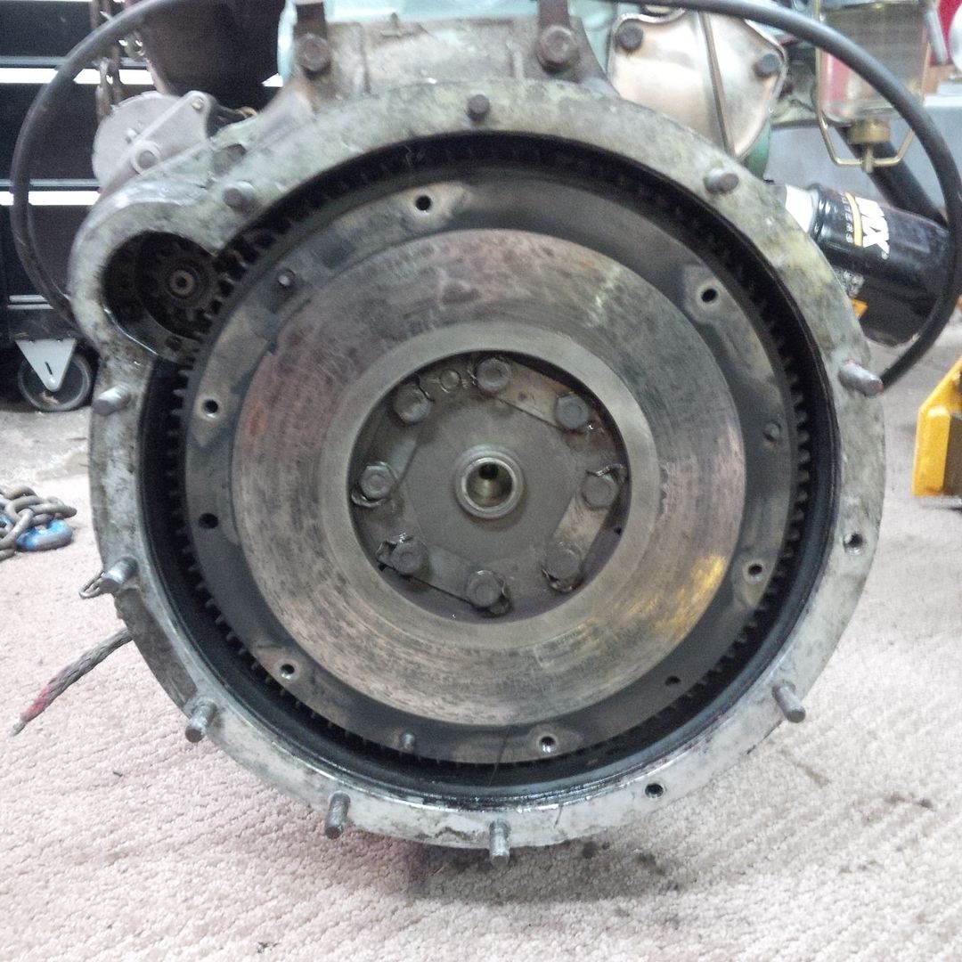

Clutch cover and disk removed, wasn't as oil saturated as I assumed...
still plan on replacing with a new unit.

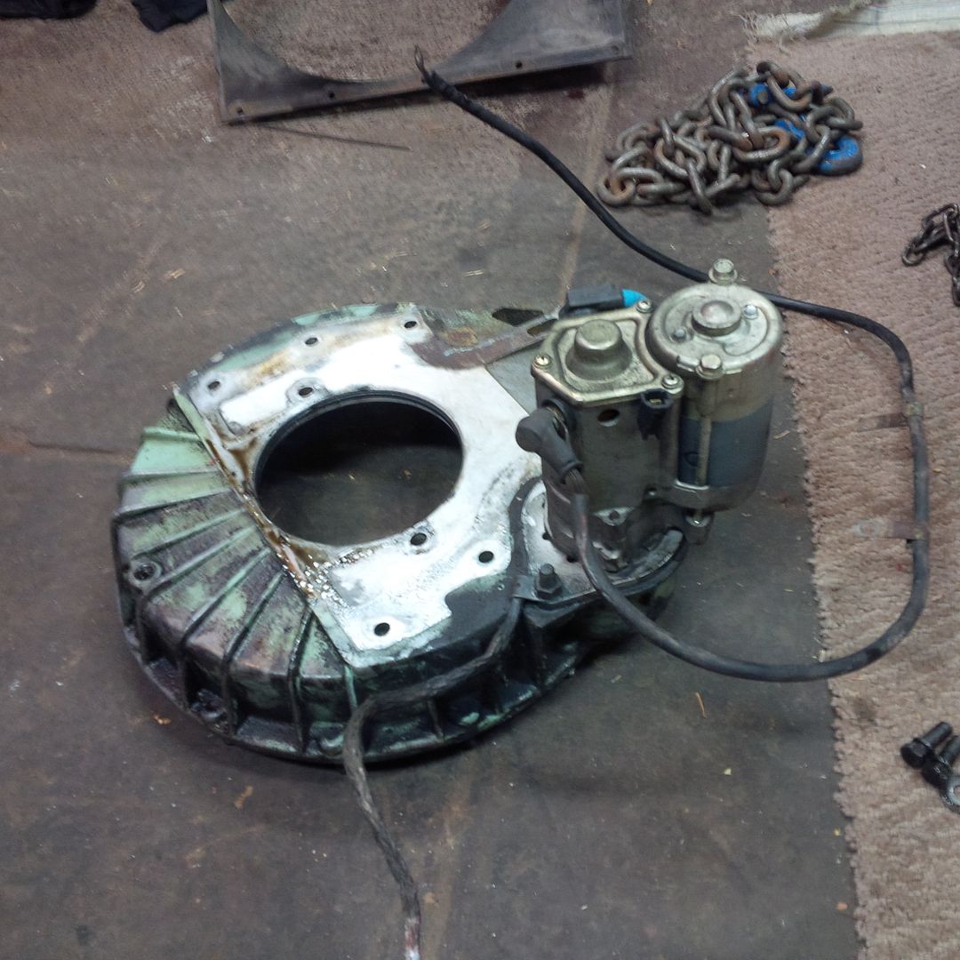

Flywheel housing removed.
Didn't even have to yank the starter.

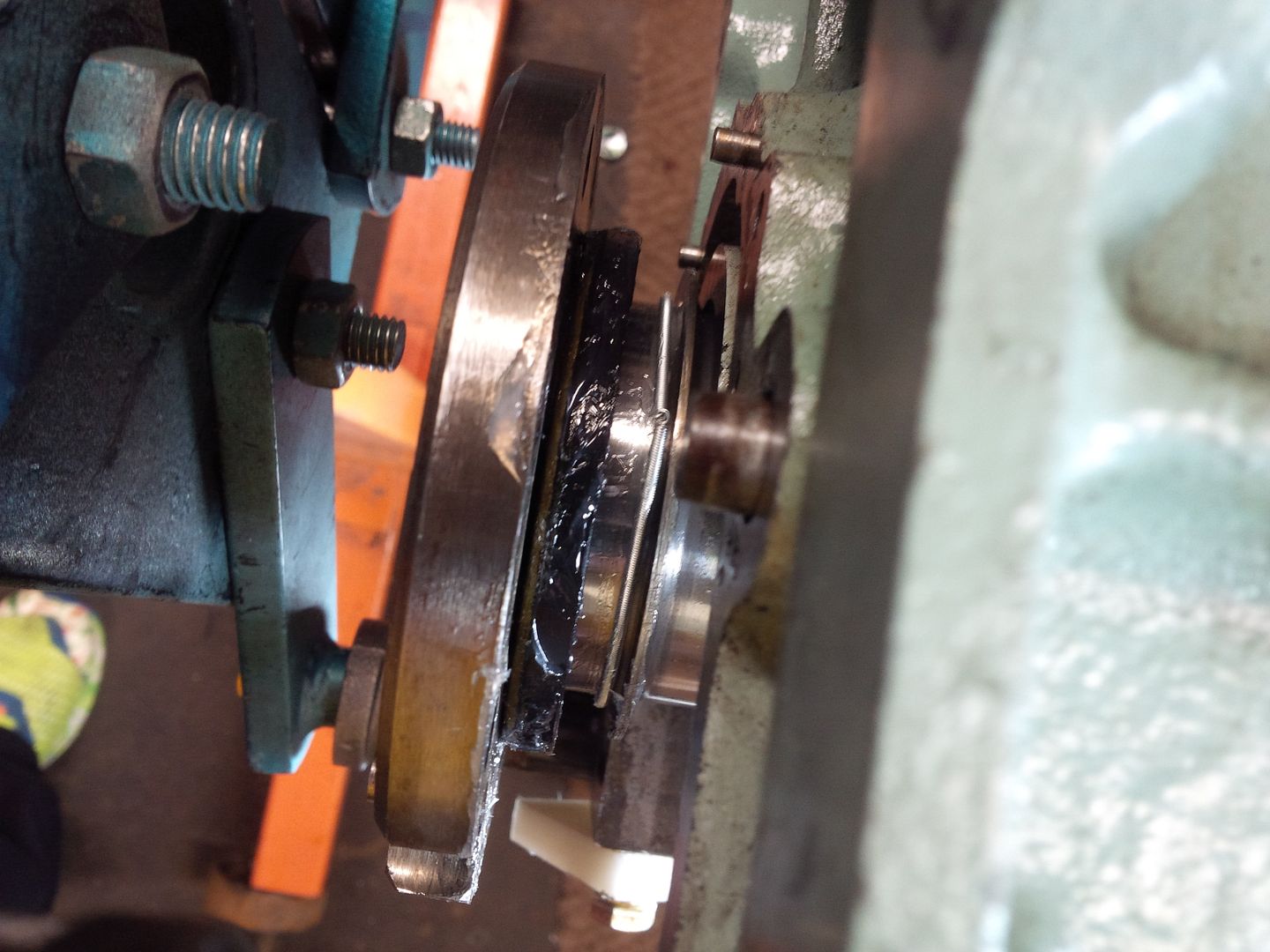

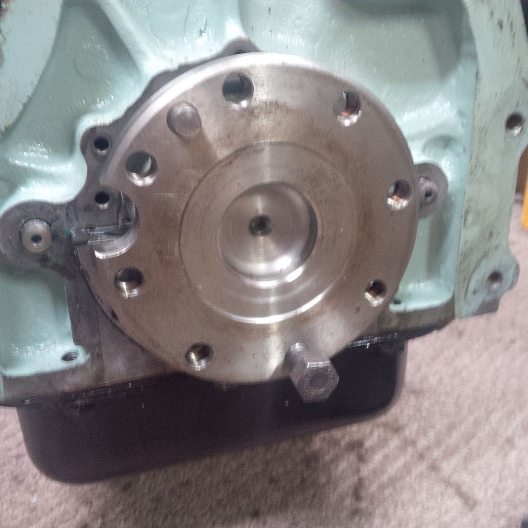

Here is the sucker...  looks so innocent sitting there...
upper seal was dry, lower was soaked..  I also noticed that there was no flywheel housing oil seal (O ring)
Unsure if I forgot to install or what...
seal retainer is located behind the flywheel flange..
some bolts pulled through the notch in the crank and the seal retainer upper half is removed.
the lower half is removed with the rear bearing cap..
Need to get the motor on a stand and the oil pan off before I go any further..

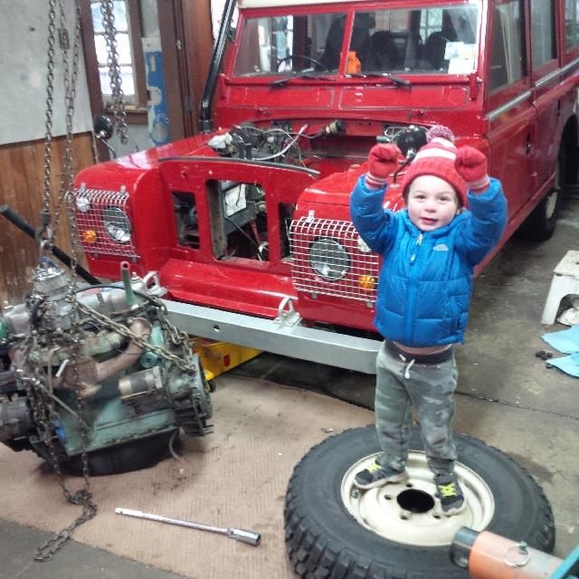

My other set of hands was really excited when we pulled the motor..
had to take the front wheels off to gain a little more clearance from the body...
opened up the wheel wheels and engine compartment a little for some other misc. maintenance I plan on doing..

everything is SO much easier when the floor comes out - aside from that (and in the dumpbus post-conversion, not even aside) it reminds me so much of a mini Cummins with the round pattern, removable flywheel, etc.
That open shifter linkage sure is something else. I'm surprised that isn't at least booted to keep dirt and gravel from jamming things up.

it is a diesel...  just in petrol form...  ;D
shifter linkage is so tucked up there... exposed for ease of service and you can shift with a stick if needed.

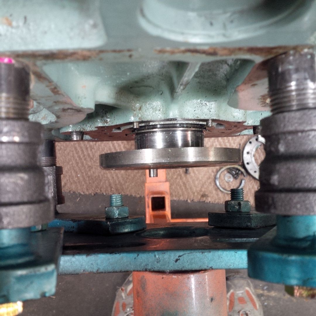

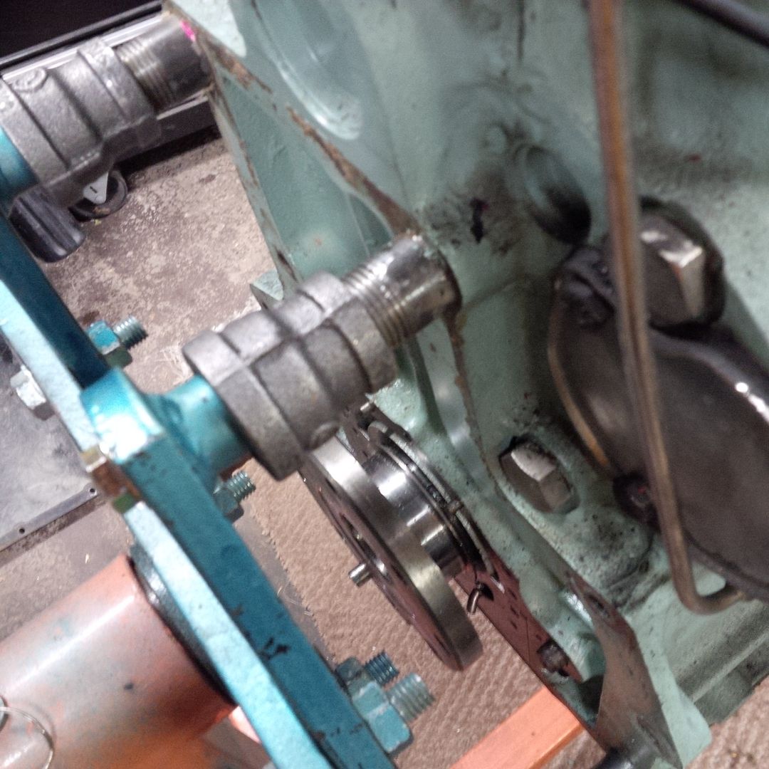

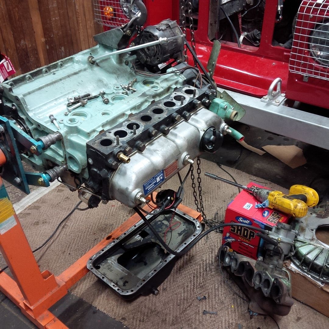

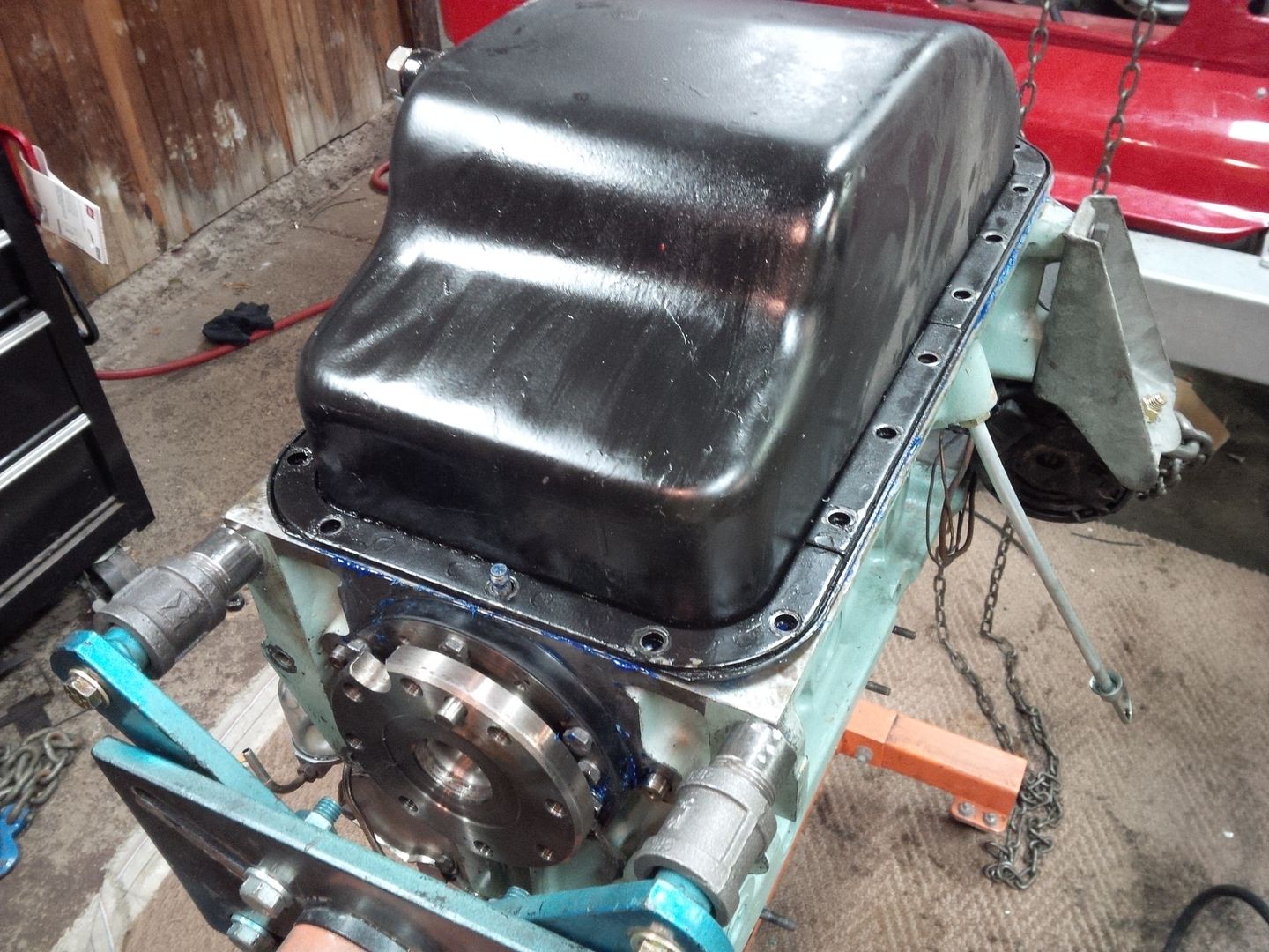

had to make some adapters for the engine stand..
goofy narrow block bolts made it impossible to get on stand without touching the crank...
some black pipe and a cut off wheel yielded these bad boys...
plenty of room to spin the crank

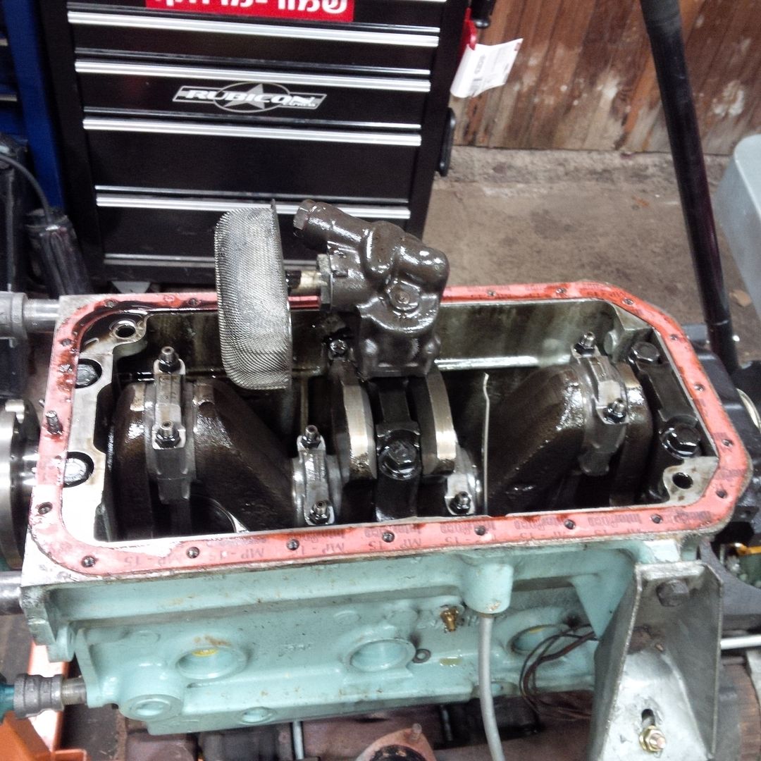

Engine flopped over, oil pan removed..
Pan gasket used is much thicker than the cheap paper one I have as a replacement..
No signs of sealant being used..
Rear bearings cap came right off.. again, a slight difference in gasket material.. the T seals are neoprene, not the cork I have as "OE"
Crank looks good, no marks or scoring.. cleaning up surfaces and parts tonight..

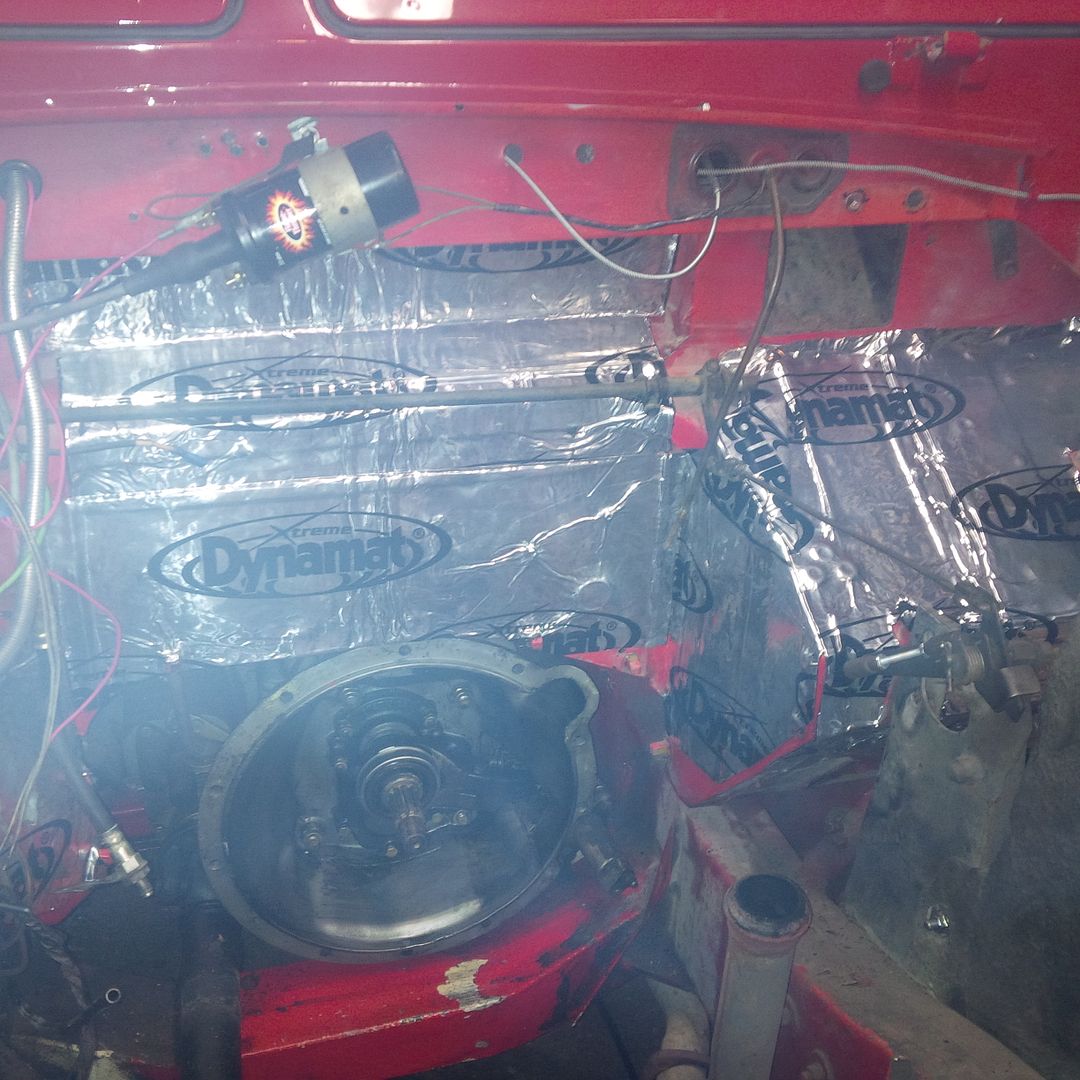

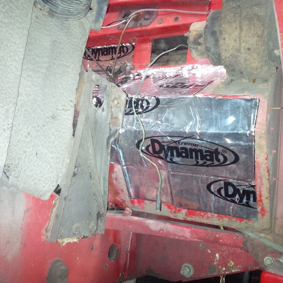

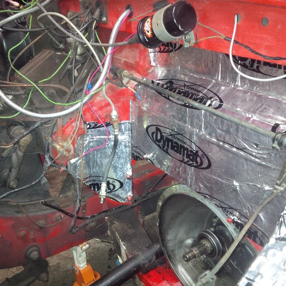

Bulkhead needed some attention..
600 grit and some brake clean, bending some metal back and new lock nuts to be installed.
Manifolds off the truck.
Figured it was out already so I would do some clean up...
Exhaust off to Jet Hot for coating, have new intake that's getting several layers of engine clear.
Got a little zealous with some left over Dynamat.  Purposely didn't not do it on the inside of the truck since I have an acoustic matt.  Some interweb grumblings about using asphalt paper in the engine compartment.. Have some 2000 deg heat shielding I will end up putting on the exhaust side of the motor.  I don't think its going to be too much of an issue..
Passenger and Driver side foot boxes will be completely covered, bulkhead / firewall done.

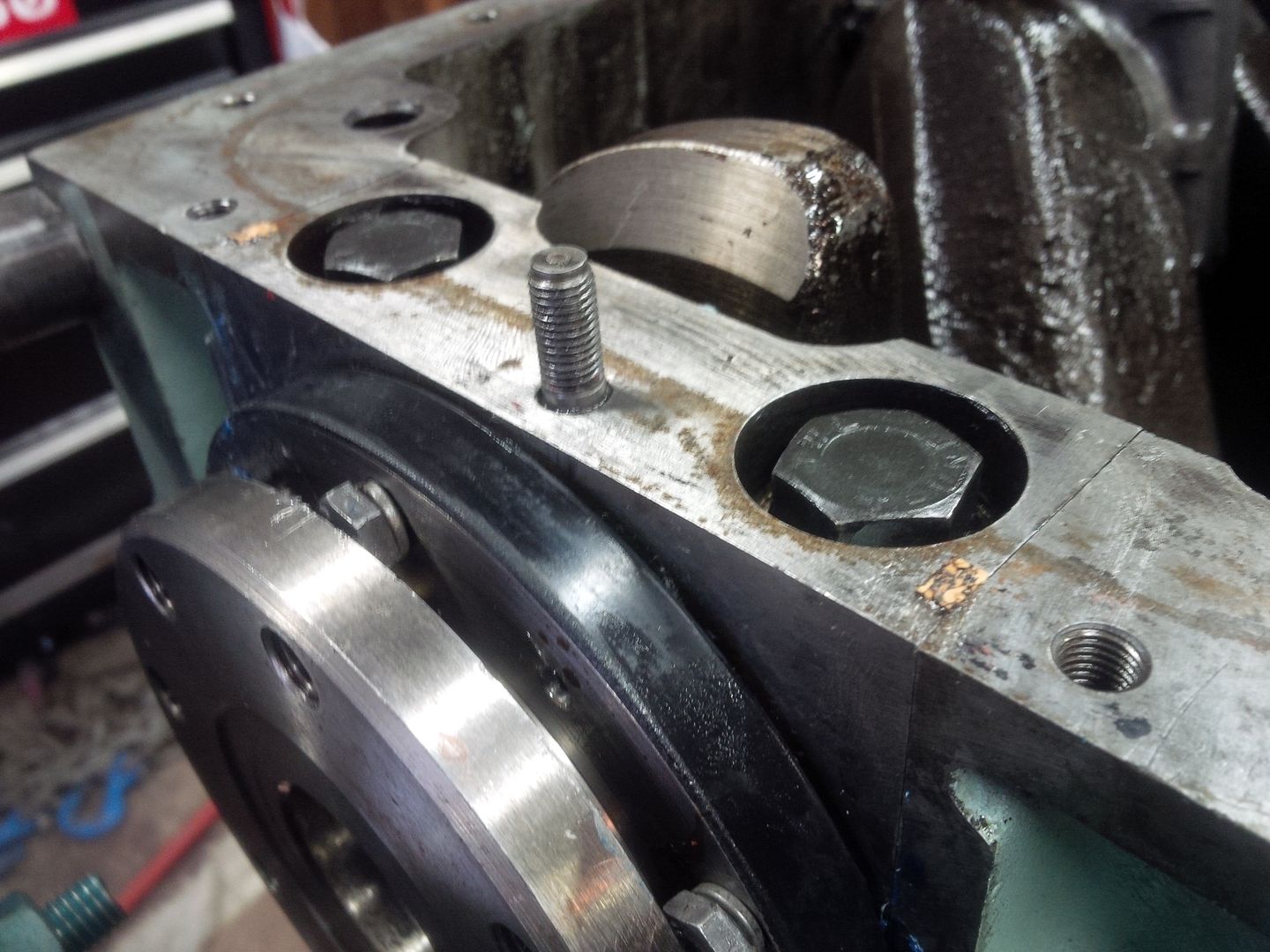

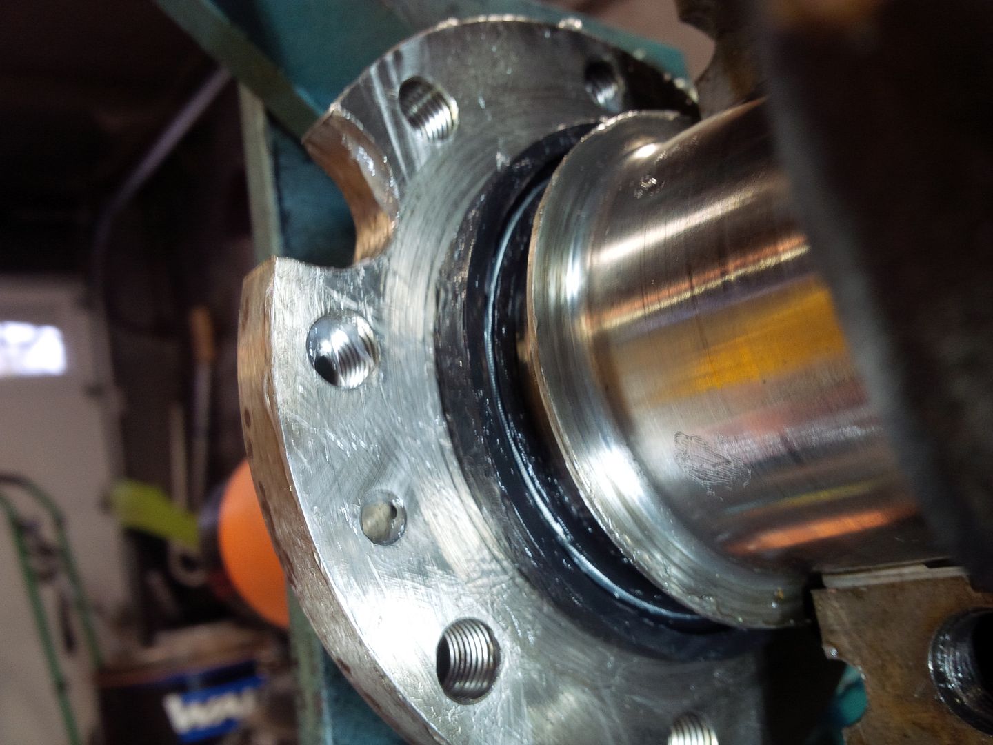

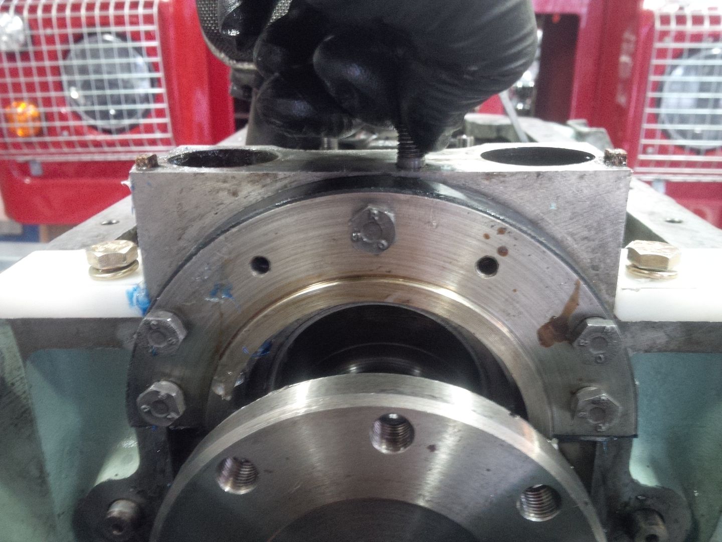

Finally did it.. got enough time to take my time and follow the instructions to the letter....
Engine stripped and bearing cap removed.

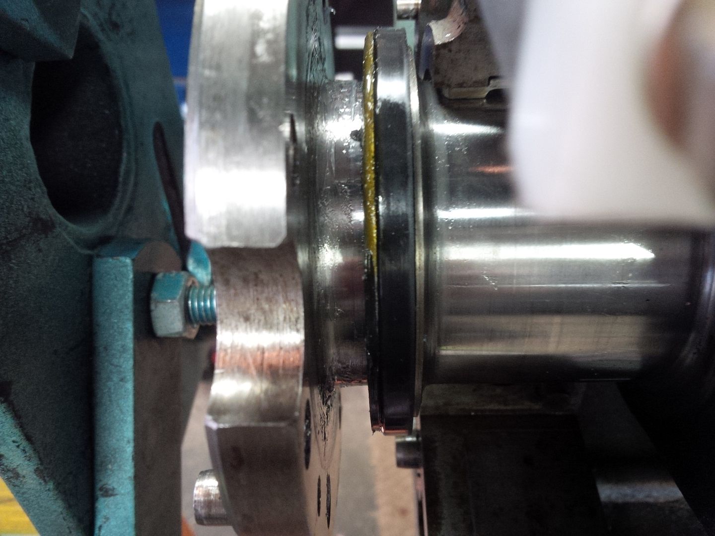

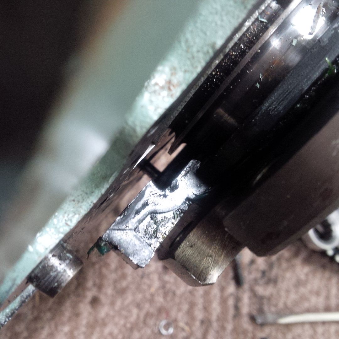

Engine turned on its side, I found this was the most ergonomic position to get the garter spring wrapped around the crankshaft.
I paid particular attention to the "don't stretch spring" and managed after a few tried to get it hooked properly around the crank.
Using Silicone grease (Dielectric) I moved the garter spring against the oil slinger and fitting the new seal, using plenty of grease.  Angle from the top seeing the position of spring and seal.
Using some optical screw drivers and a chopstick garter spring was slipped into place, again plenty of grease, being careful not to stretch it beyond necessary.

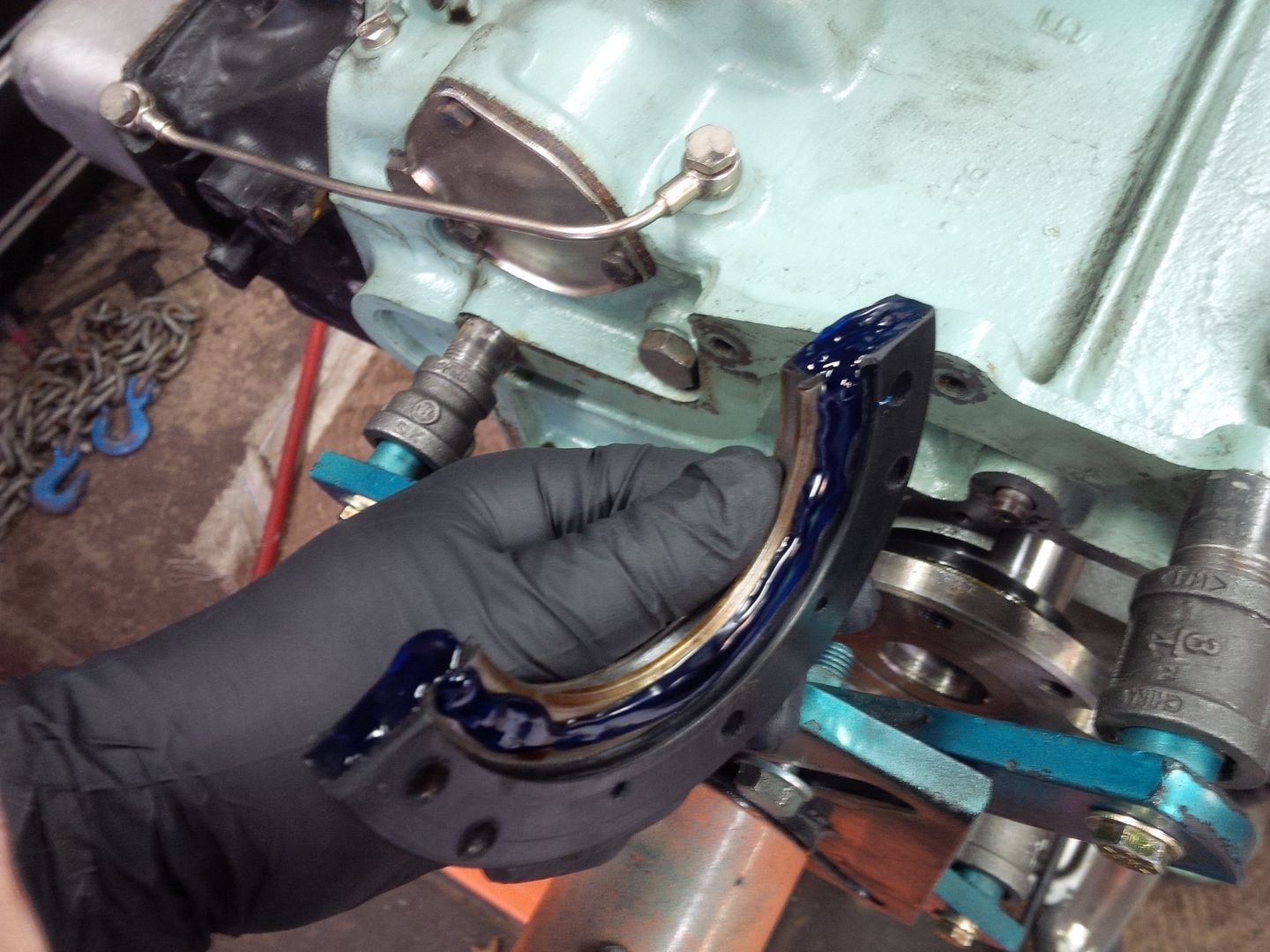

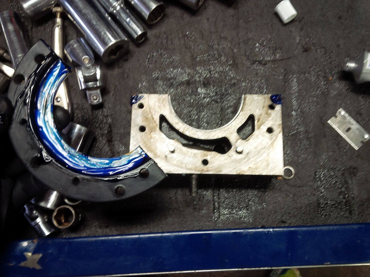

Time for seal retainer and Hylomar.
cleaned up the retainer halves using no solvents as described in the green bible..
New seal pushed up against the oil slinger in position for seal retainers.
Hylomar applied and upper seal retainer half installed on engine block..
could not find any torque value for seal retainer halves, left finger tight for the moment, just enough thread engagement for bolt heads to clear crank flange.
side note:  split in seal was oriented toward the top of the motor.  There is a cast rib on the block that I used as a visual reference to ensure it did not move.

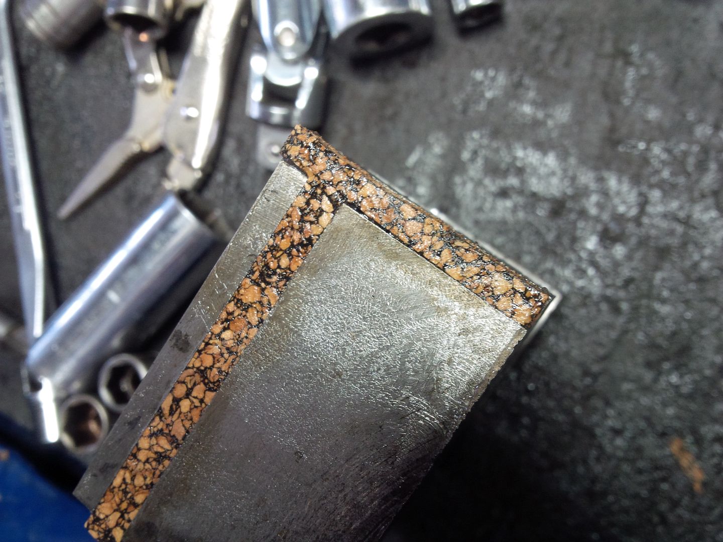

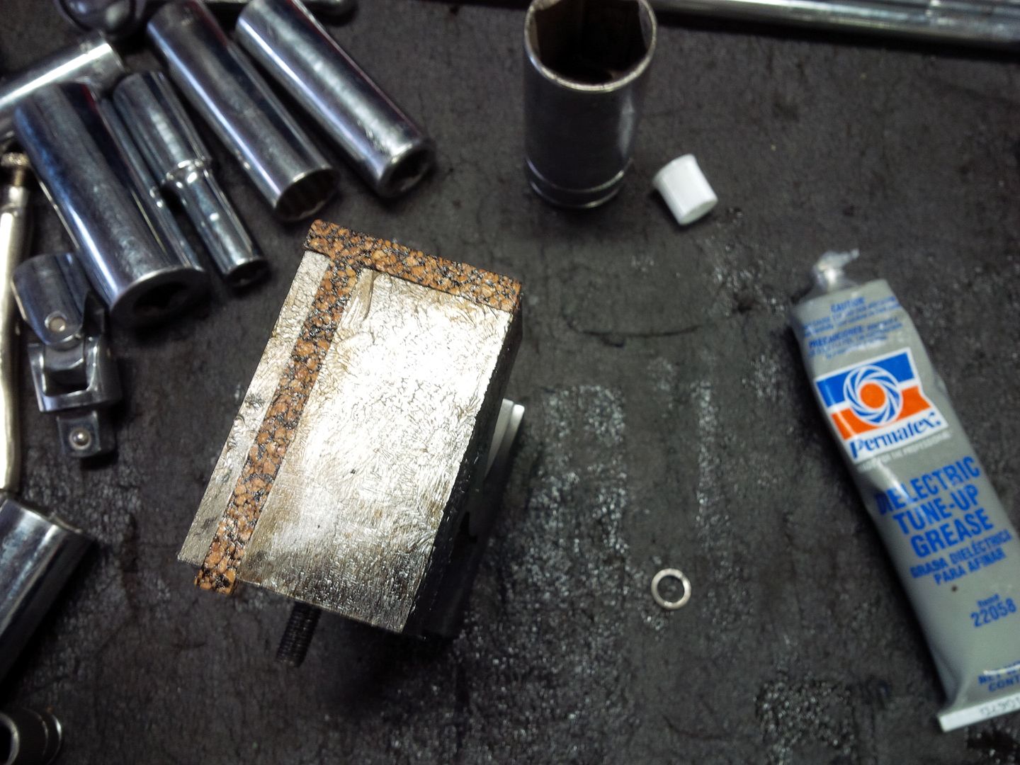

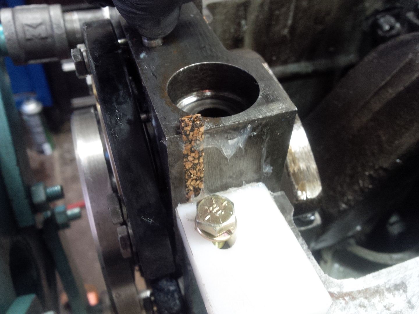

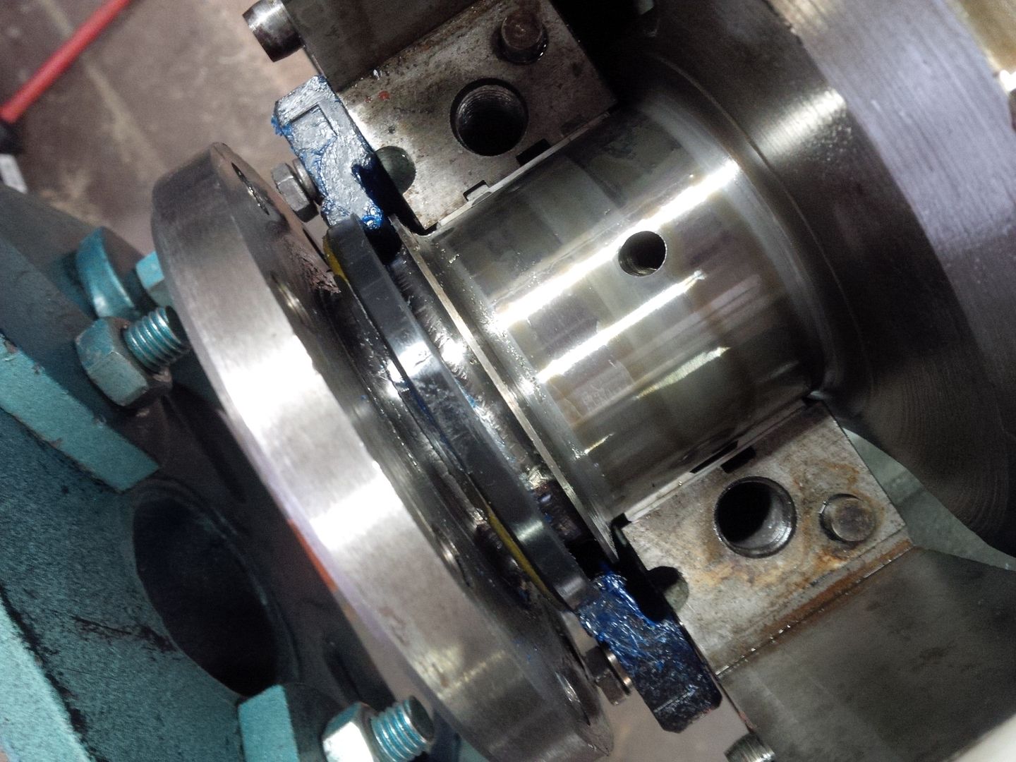

Despite what I was told about the new neoprene T seals vs. the cork I decided to go with cork..
The neoprene ones were a super tight fit, even with the grease and I ended up nicking the sides of the seal.
they just didn't install well in the bearing cap.  The rubberized cork seals went in with little effort, all lubed up and trimmed as per manual instructions.  Located the lower seal retainer on the bearing block and finger tight on all the mounting bolts.

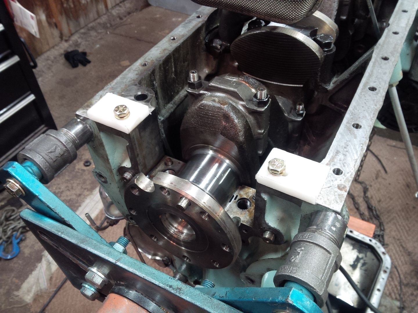

Smike provided a scrap sheet of HDPE plastic to make some guides as per SafeAirOnes installation method. (Rover guy)
cut and drilled, smoothed and beveled the edges to allow the bearing cap to slide into the block without messing up the T seals.  Seal retainer half was left loose as well to allow for proper compression of the seal in the retainer..
used a feeler gauge to ensure there was a .030" gap between cap and block prior to torqueing bolts.
seal retainer bolts tightened to "good enough" and exposed T seal material also trimmed to .030 in. "proud"
all done for now unless somebody tells me I did something horribly wrong and I should give it another go..
