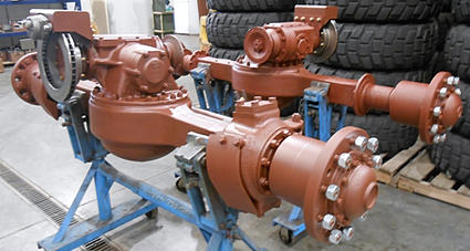

also.... what is this drive shaft speak?  its a pinion brake, not a transfer case output brake people... no load on shafts unless your doing a brake stand
never mind.. this solved it for me...
no more discussion needed...
I was picturing this kind of setup but with the brake on the driveshaft side of the axle pinion..

Cut and paste:
Q: What's wrong with pinion brakes?
A: Nothing, really. Pinion brakes are awesome but there are some things that need to be understood about them. The main thing is that the reason they are so effective at stopping a rig quickly is that they use the Rockwell axle's deep gear reduction to multiply braking effort whereas a conventional axle has the gearing working against the brakes. But in exchange for this multiplicative effect the pinion brake spins 6.72x faster than a conventional wheel brake would. Thus, roughly about 6.72x the heat is developed to stop the vehicle. At 30mph braking at the pinion is very similar to a normal wheel brake rig riding the brakes at over 100mph!!! So pinion brakes are really good at stopping a rig quickly but not for long periods of time. If you don't ride your brakes coasting down long hills or go fast a lot then pinion brakes are probably great for you. But if you drive on the road or wheel at places like Harlan, KY pinion brakes probably aren't the best choice.

Yummy, want.
Re: 572
« Reply #835 on: December 18, 2013, 08:24:56 AM »
Those look good.
