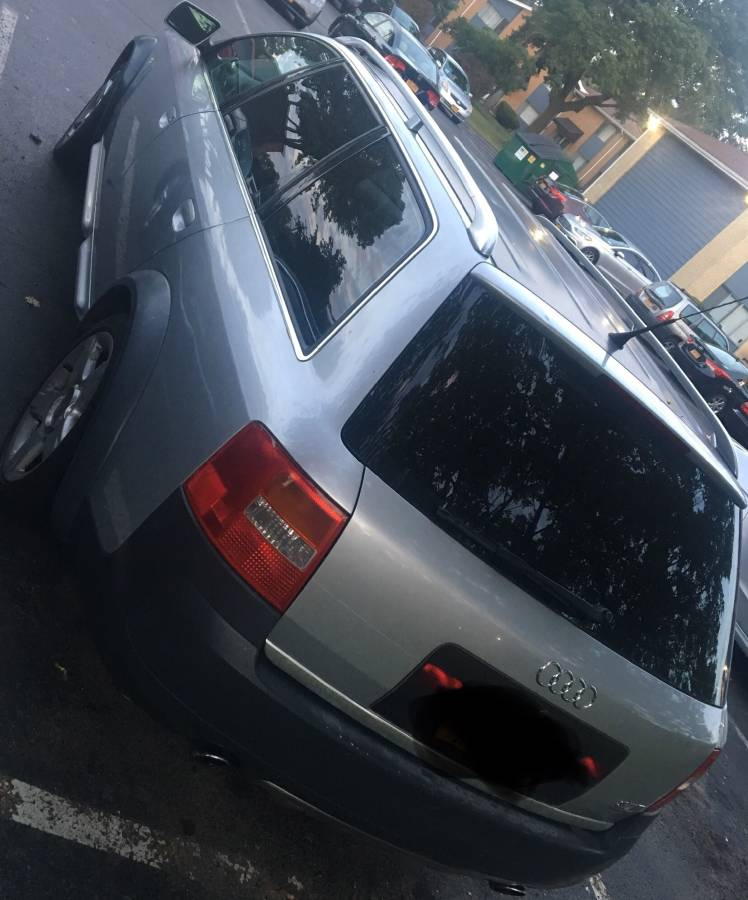

Asking $2000 in Greece NY, finally got back to me after a couple days. Can look at after 7p, but I've got flashlights.

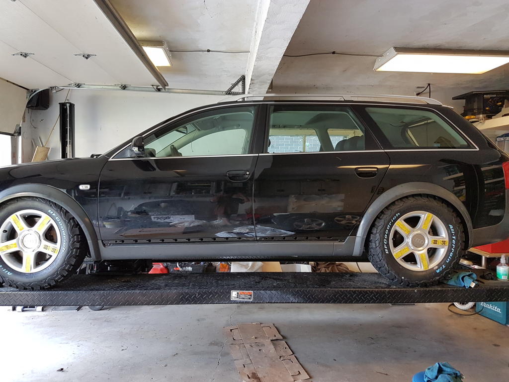

lift kit credit to this post https://forums.quattroworld.com/allroad/msgs/266318.phtml
photos all broken in the post, I rehosted them. they are still online now but I don't want to lose them.
Quote
I've been working on an 2" lift kit for the allroad, and after several months of testing, here it is
Posted by: silva (1473) on 2017-11-05 10:51:38
Reply
Share | Report
After seeing Nogaro Nitwit's allroad with the BFGoodrich KO2 tires, I really wanted to do something similar. Having learned that he had some issues with the tires rubbing inside the wheel wells, I decided to lay under the car for a while and see if a light bulb would go on. I think it may have!
What you see in the photos below is level 1 at where level 2 used to be, and then each subsequent level being higher. You can also see that there's a 6" difference in height at level 4 compared to an allroad at level 1. There's a minimum of 11" of ground clearance (under the belly pan) at level 4 while most of the rest of the car has 14" of ground clearance. It's silly, really, but it works well. Another benefit of this is that even with the air suspension fully deflated, the over-sized tires do not rub in the fender liners (untested at full steering angles).
This was achieved by installing some 1" delrin body spacers between the front and rear strut mounting plates and the body. I designed and had them CNC-machined. A 1" spacer on the strut has lowered the location of the bump stop approximately 2". This will put the minimum height (fender to ground) at approximately 26.5", which is about the same as the stock allroad tire diameter. With the BFG 215/70/16 there is no rubbing with the suspension fully deflated.
The vertical connecting links between the suspension and the height sensors have all been lengthened by 20mm. This allows the Level Control Module (LCM) to work within its designed operating parameters. I initially tried to program the LCM so that level 2 would be 35mm higher than level 1 (making level 1 equal to previous level 2) but the LCM does not accept values so far out of its programmable range.

Checked out the silver $2k car tonight. Drove it. Has some electrical issues, and is no longer on air. Was spring-swapped. otherwise very good.
Hvac controls and function were flickering, and known and confirmed bad wire to oil pressure sensor. Sensor and pump swapped. Has some oils leaks from pan gasket issue and valve cover gaskets are needed. Shifter brake-park interlock is non-op and needs a screwdriver to go into gear.
Could be patched into Wonder status in a couple hours with a mechanical oil gauge + hardwired sensor and some shifter parts broken off. Oil leaks aren’t bad enough to preclude driving. Just to preclude parking in the exact same spot all the time.
